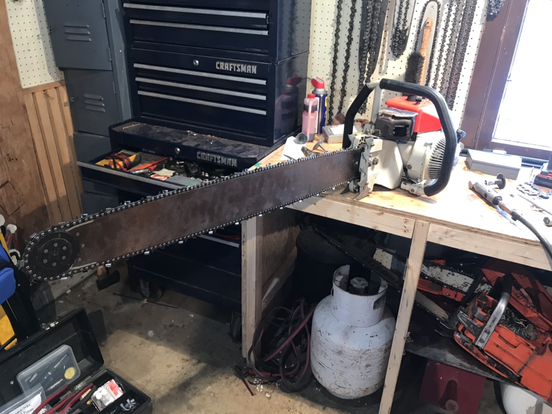

Homemade
3:11 AM
2986
Apr 8, 2017
1,125
2,760
Wisconsin
I threw that bar on today and spun up a 3/8 chain for her to wear. 35” of cutting reach. Nobody around us sells or much less knows what .404 is, so I’ll have to order some. Nice think about roller noses. Any pitch fits.
