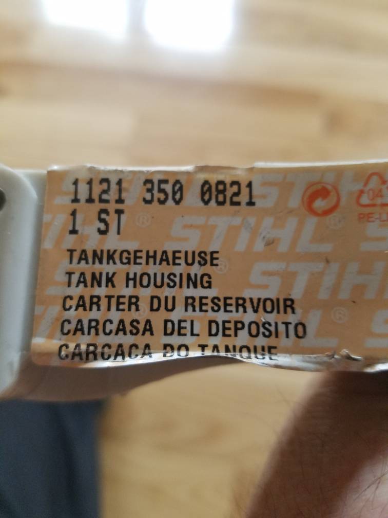

OK this is the vent setup that this tank dictated.
Sent from my SM-G955U using Tapatalk
That the one we figured out with the measurements of the base where the vent filter and cap fits in?

Only including that tidbit due to several saws being dropped off to me that had busted rear handles and the replacement tanks were not from the same year as the saw chassis.

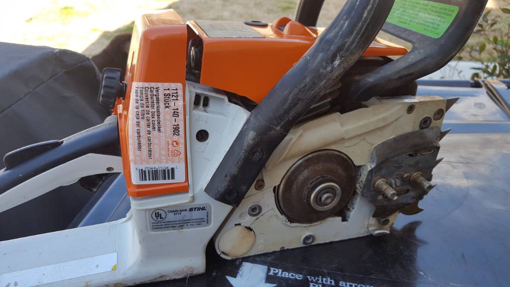

This saw came in missing plastics, air filter, tank vent filter/cover, clutch cover. It is a clear tank saw. The saw shows less than 5 hours of run time. Why it was taken apart I have no idea but it had been sitting for years.
This tank also takes the smaller molded line [NLA] not the 11.5mm one.
The tree service that wanted this saw hangs his saws bar down on the side of the chip truck. Leaking fuel is a real concern for him as it dribbles all over his chip truck and potentially on customer lawns and drives.
The duck bill I replaced had a very slight deformation. I am guessing age had gotten to the rubber (it's probably between 15-20 years old) and was not sealing like it should on the tank.
New black duck bill, filter, and proper cover and it seems to do fine right now.

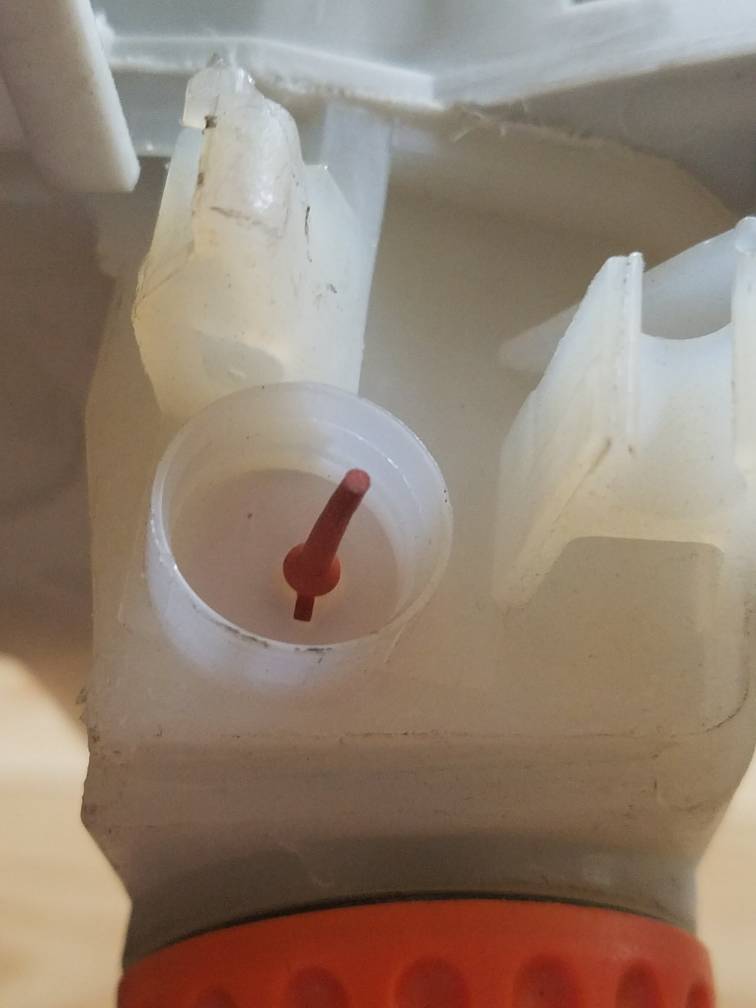

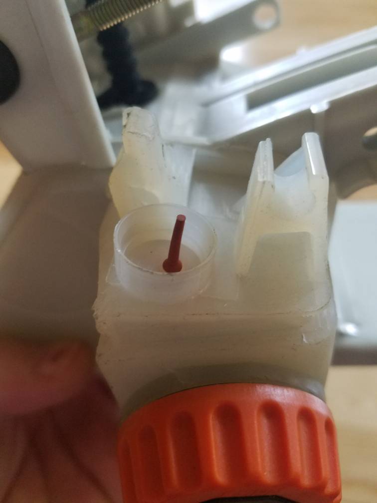

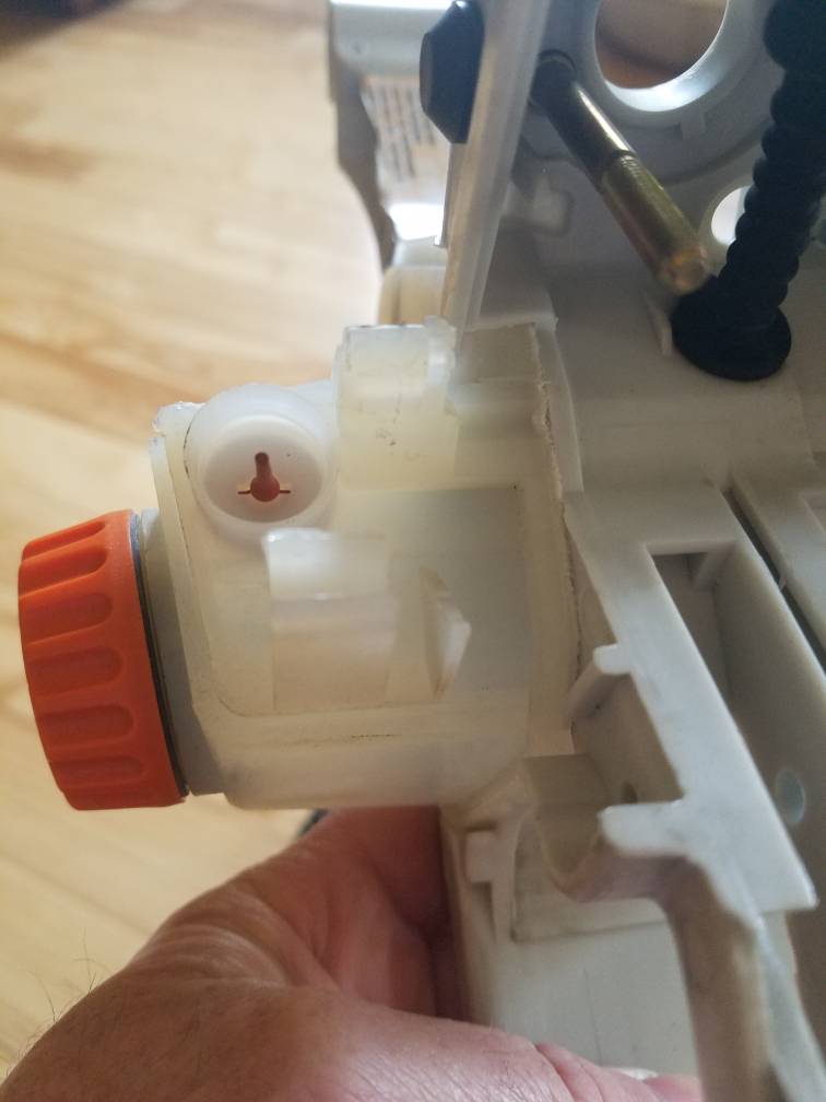

I snapped a few quick pics of my spare tank.
Which vent is needed here?
Duane(Pa)
It's the chain...
1:05 AM
325
5,093
25,364
Centre County
The one I have that looks like that leaks (bad). I wonder if maybe it has the wrong cap? Doubt it, as it was basically NOS when I bought it. What I would like to do is retrofit it with the black duckbill insert, or maybe the 260 style. Has anybody been down that road?

The one I have that like that leaks (bad). I wonder if maybe it has the wrong cap? Doubt it, as it was basically NOS when I bought it. What I would like to do is retrofit it with the black duckbill insert, or maybe the 260 style. Has anybody been down that road?
What you have is the latest style of 026 valve. IMHO it's the best. I'd get a new rubber flapper / check valve and roll on.

Is this my best option? Only option? Or is it possible for me to upgrade to a better vent?
Like Jimmy said, its the latest version, it works well, parts are easy to find and if it were me I would keep it original and just replace the parts that are missing. All these various vents worked well if the parts of them were still in good physical condition, Stihl only changed them as they were forced to do to meet EPA pollution conditions that the EPA was bound to change every few years.
