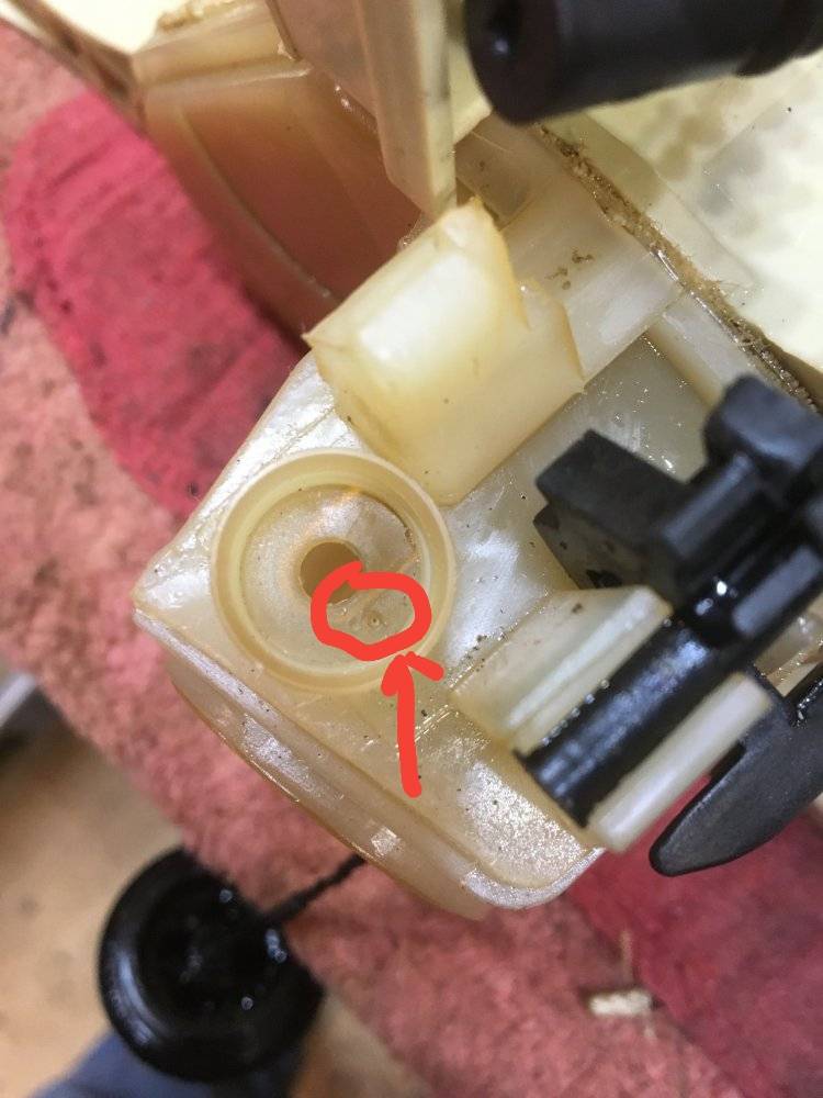

Same issue with an 026 here right now. Same style duck bill in my tank too. Did a new duck bill solve your issues? Why is there an extra hole in the tank to the rear of the duck bill hole?

Extra hole circled. I thought my tank was defective...clearly its not. I am guessing the top and filter are to hold the sides down tight and keep that from venting.

LOL, now Jimmy. The center hole is completely blocked by the umbrella retainer nub, the second hole is what allows air to enter the tank past the umbrella`s lip, the lip also seals air /fumes inside the tank. The older tall black tower vent allowed air and fuel fumes to vent both ways, that became a no no due to increasing EPA regs.
I thought the air came through the middle of the duck bill.

I thought mine was a made fit but seeing the exact same thing here says it was factory... especially since the OP got parts at the dealer. I think the key is getting the proper sintered filter and cap with a new black duck bill.

I thought it was the vent that used the orange umbrella type valve but the center hole does look a tad large for that type. Bet someone opened that center hole up to use the black duckbill type. There would be no reason to have the second hole on an original black duckbill vent, the second hole is used for the orange vent . Who knows what has been done to used saws to make them work. All newer saws are required to have a sealed type one way tank vent that only allows air in to replace the fuel drawn out, no air or fumes to escape.
I agree ... but this saw showed no use. Means nothing ..... but I still think the proper top will make it work proper.

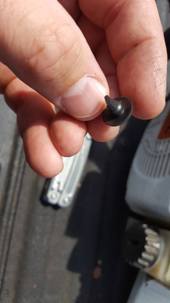

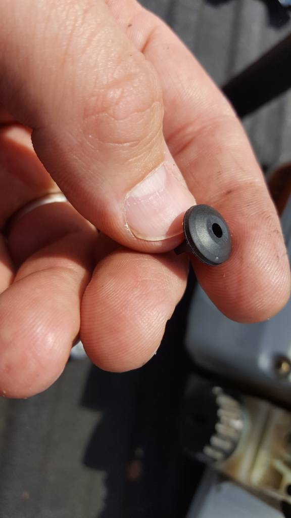

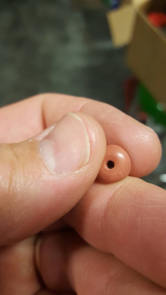

The orange one is very small compared to this one...well the orange duck bill Dave sent me is compared to this.
Sent from my SM-G920V using Tapatalk
Yeah it’s kinda small. I tried the black ones but they wouldn’t fit. Didn’t wanna drill it out so I got another orange one.

This is mine I have now. Sorry just got home View attachment 107816
I'm confused... you show pictures of the black one in a previous post installed.
Were you able to make the small orange work where the large black was?

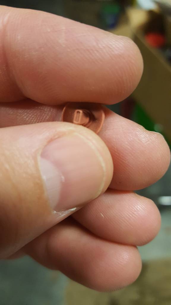

This is the Orange mushroom everyone talks about. Note the size difference vs the black one... also not split like a duck bill. These are OEM from Dave.
