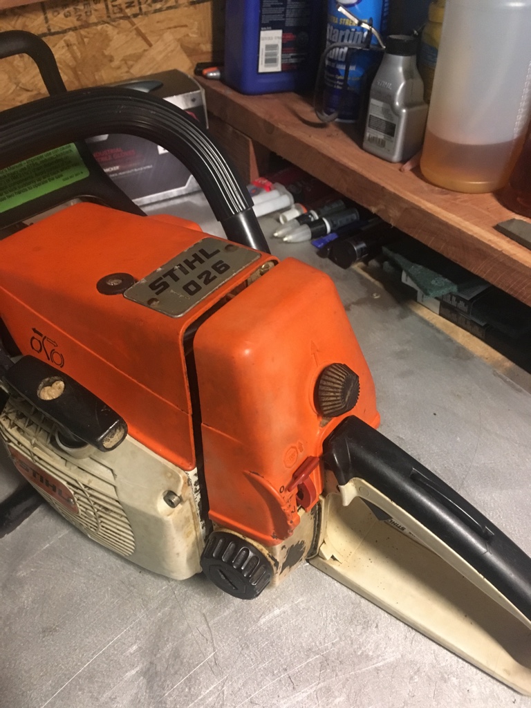

So tonight I get home and pull the old throttle trigger and master switch out of the saw, I can't tell that their worn at all.
I go ahead and put the parts I salvaged off the scrap 034 on the saw and they display the same thing, butterfly is fully closed in the lower 2 positions of the switch. In a fit of frustration I took a pair of pliers to the metal connecting rod as it was the only way I could figure to get any slack out of the linkage. What do you know, after 2 slight bends of the rod I put it back in and the saw ran perfectly! The saw was still cold at this point so I choked it, pulled 3 times and got a pop, moved it to fast idle and the saw took off. Now I have an 026 that runs like a raped ape and has a cool retro red trigger.
I really wish that I knew where the slop was coming from that caused this issue in the first place but either way I am happy to have this project complete. Thanks for all the help and advice you guys provided.

I think the slop is in the pivot pin in the trigger or in the handle

Just out of curiosity, does your saw have a carb with only a L adjustment, or does it have both the H and L adjustment?
What kind of carb has only the L adjustment? Compensating carb?

I have several of the single adjustment carbs. I think they are all Walbro carbs. Every time one shows up, I replace it with a fully adjustable carb.
Yup. Walbro WT 403A. Just the L and the LA screws. WT 194 has both the H and L and LA.
Check the connection between the throttle rod and the carb lever. It is hard to see in there and I believe that there is a small hole in the carb lever that the rod has to snake through. Once this is correct and the rod is not bent everything should work as intended.
As a check squeeze the trigger and engage the choke. Raise the control lever up one notch. squeeze the trigger again. You should hear a snap indicating that the throttle linkage has returned to the normal idle position.
