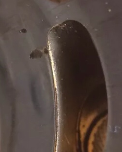

I guess it’s pretty safe to say this 044 cylinder that someone is selling is toast isn’t it?

Hmm, might be the result of a hotspot. I wouldn't pay anything for it, that's for sure.

Hard to tell from the pic, but if those areas are smooth (no high spots) and are below the port (which it looks like they are) it could be run without a ton of concern.
The picture is look in from the bottom of the cylinder (it’s kinda upside down so it’s above the ports. )
