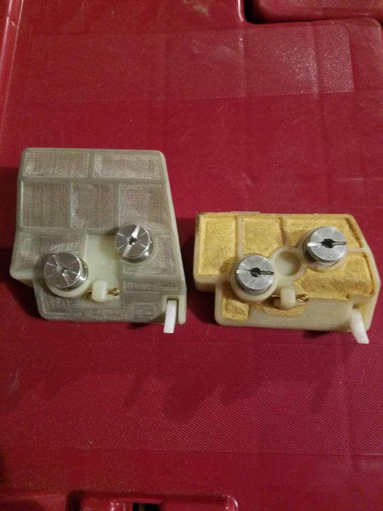

l have a like new air filter for an 024 if you are interested.
It actually came from a Stihl dealership as an acceptable alternate filter for an 026.
I removed it right away and put on an 026 metal mesh filter. I will get some pics for you.
Metal mesh 026 filter on left, stock 024 filter on right.
