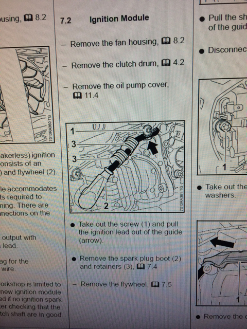

Working on a 201T today. Is the coil wire supposed to be tucked into that channel/retainer that is just behind the wire?

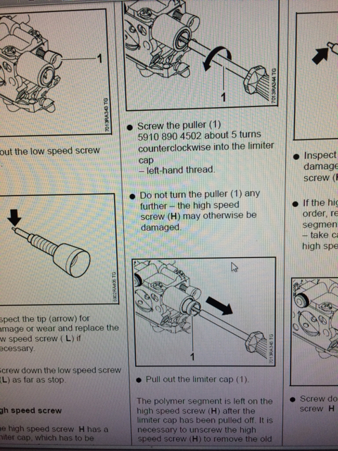

Also what is the trick to getting the H limiter cap/cover pulled out?
X 66 stang347 X

The limiter pulls out

I think so, I just haven't seen the #3 "retainers" before. Maybe they just keep the lead from burning on the cylinder?
