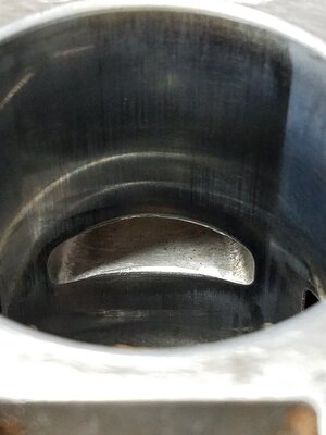

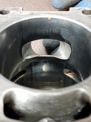

The world famous Mickey Mouse intake port that Ol Pot Metal Pony showed off on his YouTube channel traveled all the way to Canada. A customer sent me a 661 that he bought in for port work. The only problem is that its already been "ported".
The intake floor has been lowered a fair amount, and widened. As a matter of fact, its wider than the piston skirt.
They didn't raise the exhaust port, but they widened it to the point that they got into a ring end pin. Their solution to that was to throw away the second ring....
We have a new top end, muffler, heat shield, and gasket on the way.
Please don't copy the garbage you see on YouTube.

Sad state of affairs when you can’t tell your saw is ported already. @Coop The Cutter sent me one awhile back that had already been ported. Fortunately I was able to take several measurements and determine that they hadn’t removed much from the squish band and I could still do things that I wanted. I believe I gained 24% on what someone had already paid to have ported

I could probably use a full skirt piston and save this jug.....but I don't know if that would cause the wrist pin bearing to overheat or not.
Dave’s pistons might work, if he still has any. At one point in time he was getting all of his pistons for Stihls swapped over to 1.2 MM caber rings so they didn’t need to be replated
Unless you care to attach your name to his with this saw forever and ever, you might want to consider sticking with plan A and make it a saw strictly from you and you alone.

Oh....I have no intention of doing anything but replacing it with new oem parts.
Technically.....I could find a way to salvage it, but its not something I'll actually do.
The port work, though done all kinds of wrong, looks pretty good.
