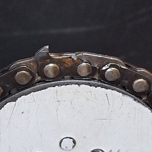

Put a tree down in the back yard, hollow, with a dead snag at the top, and set where the dogs' tieout/run would let them get wrapped around.
Bucking it up into rounds, though most were C shaped from the hollow.
Putting metal in trees should be a crime. Not normal wire fence looked close to ¼" took 2 cutters off completely. This one down to the rivet. Went in to sharpen the cutters saw 1 missing sharpened 1 side and got to this one 🤦
Swapped the chain. Will take it to have the 2 cutters replaced and make it my dirty wood / stumping chain, as well as practicing square filing on as I've been wanting to try square.

Yeah I have not ponied up to the world of breaking a spinning rivots. Thinking of doing so... I'll have to take this to a dealer and the only Stihl dealer I know still spinning chain is almost an hour away.
Harbor Freight has a setup for about $70, relatively inexpensive way to get into it. I got lucky and my work was tossing out their old Oregon equipment to upgrade to Stihl, so I got the old stuff!

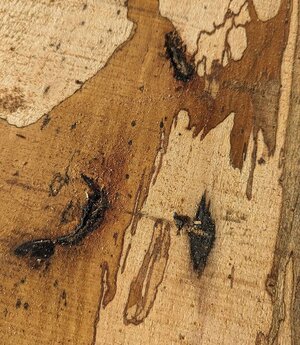

I brought home a tree recently, Turns out the base was solid but the up from that and center it was on it's way out, Upset at first but then figured I could use it for something else. Halfway through the tree I discover a metal sign hiding in it and of course it's always the freshly sharpened chain that finds something.

It's not that hard to repair chains without special equipment. Just grind/file the rivet heads flush and the links fall right out and then peen the new heads over tapping round and round with a ballpeen hammer. Breaker/spinner setup is really just a convenience...
