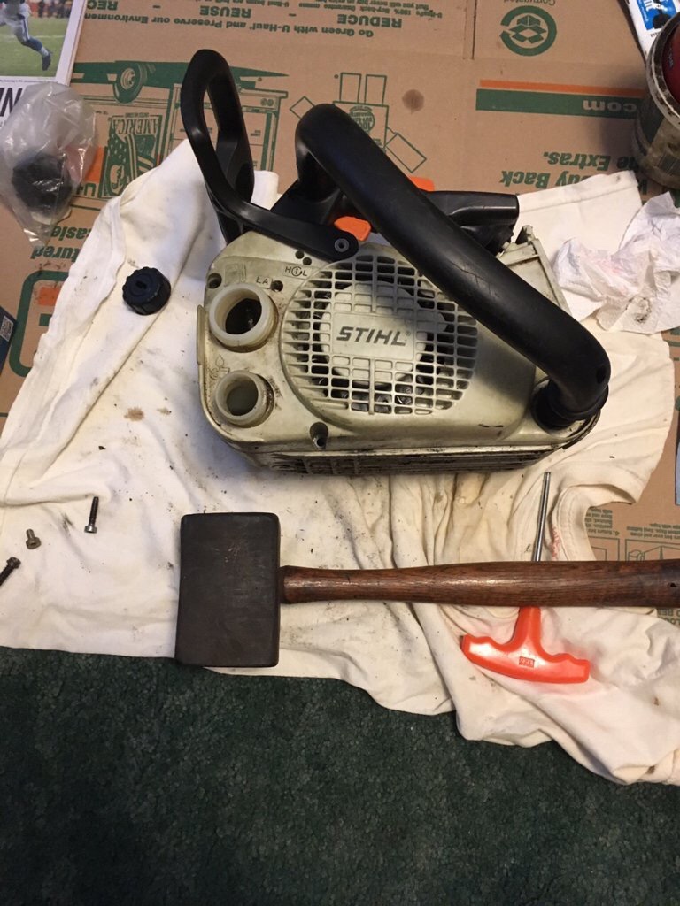

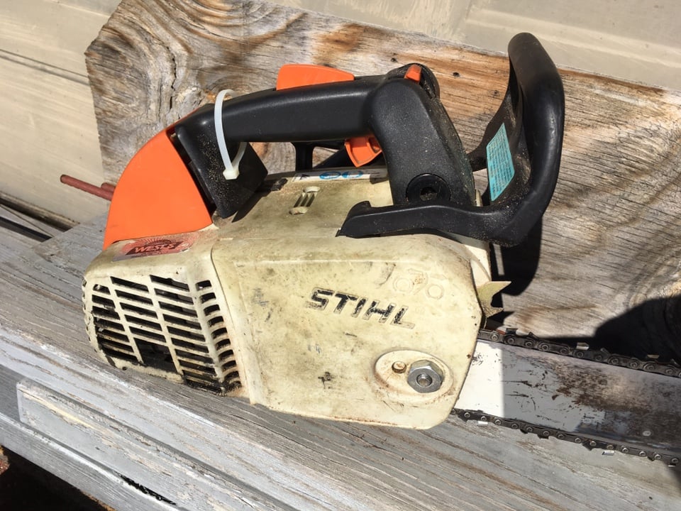

Not having ever come across one before I snagged this off evilbay.
It had achieved high milage with little mix oil or just plain straight gassed.

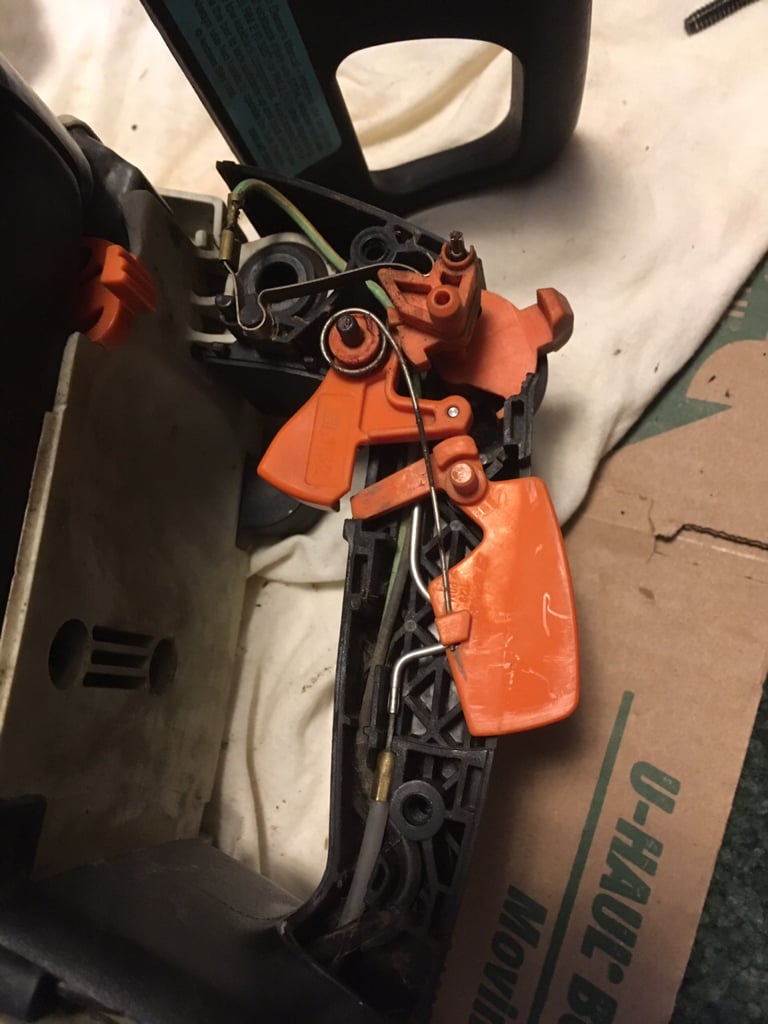

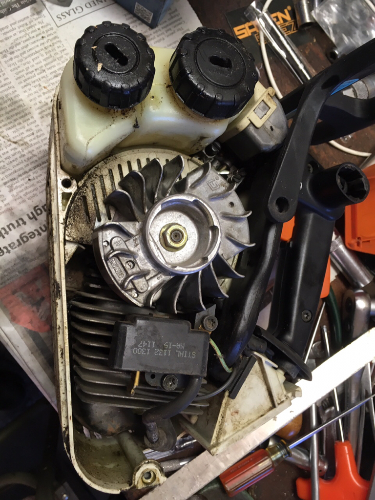

It’s an early production with a one piece flywheel/starter cover. It’s necessary to remove the wrap handle to get that off.
Remove the handle cover from the wrap and put it back so the guts stay put.

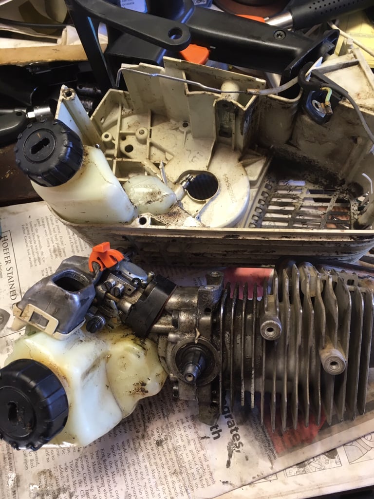

Anything past a spark plug, fuel filter or air filter requires engine removal from the plastic case.
Stihl version of a little red Homie XL complete with reed valve. [emoji15]

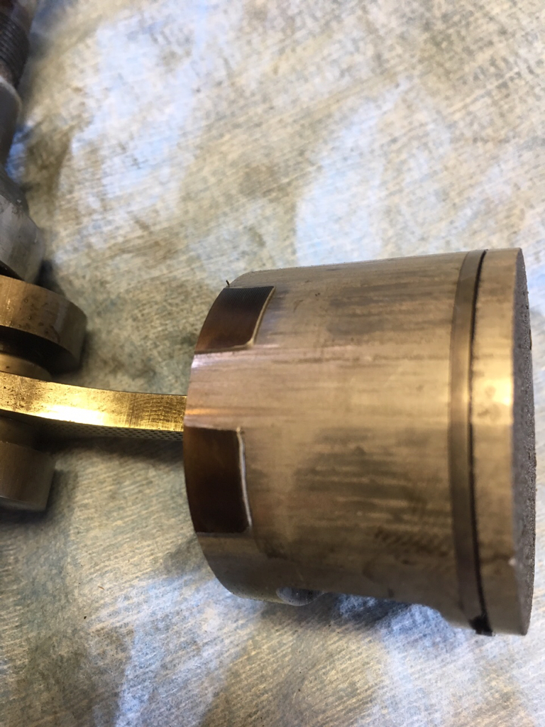

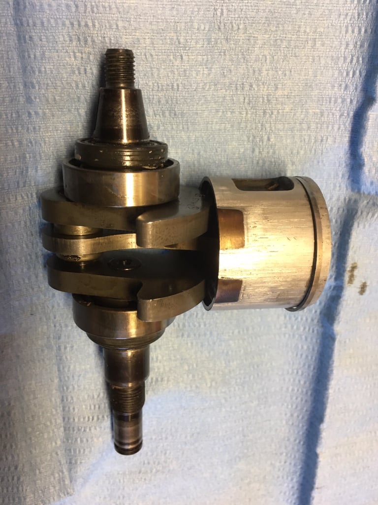

Lots of piston skirt worn off.
Them untouched ‘pads’ are .005” above surrounding skirt. [emoji2960]

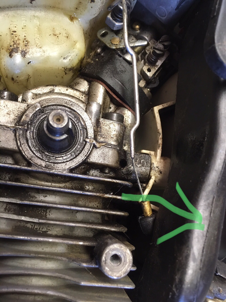

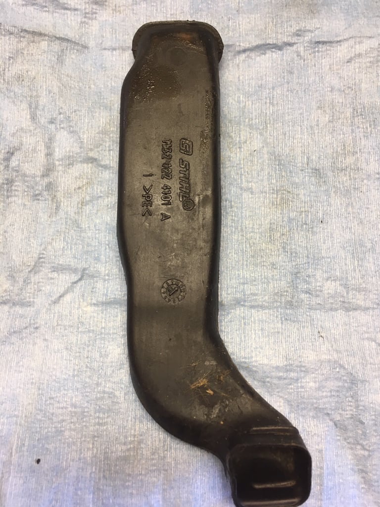

With the carb in front and air filter in the rear a long plastic duct connects the two.
Them Krauts are problem solvers for sure. [emoji849]

The discoloration of the crank scared me so we replaced it with new.
Piston kit from my favorite dealer took four weeks to get in.
The cylinder had lost a patch of crome so we got a nice one from Travis in Stanberry, Mo.

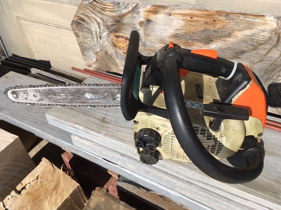

All back together it was a *b-word to pull over. Mostly due to my assembly oil (mix) and trying to keep it planted on the floor while pulling on the rope. [emoji2959]
There is no dribbling fuel in the carb because of the long ductwork. [emoji90] So one just yanks and yanks hoping to not wreck an AV mount. [emoji2955]
Good thing I went thru the carb as I dint want a ‘do over’.
Now that the assembly oil is blown off it pops on second pull and runs on third.
It has a lot of parts in common with an 017. Crank, bearings, seals, oil pump and drive train (clutch etc).
