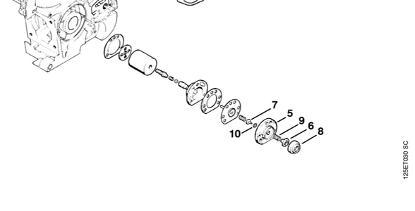

My Stihl 009 is not oiling. I have cleaned and rebuilt and ultrasonically cleaned everything and still, nothing is happening. Any thoughts?

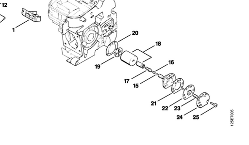

It is usually the diaphragm that goes bad in the pump. Number 22 in the picture. The part number is 1120 640 3100. eBay and Amazon I see have them.

The diaphragm is fine. Just replaced it with a Lil Red Barn kit. I like their stuff cuz it gets here so damn fast cuz they're only 5 hours away
