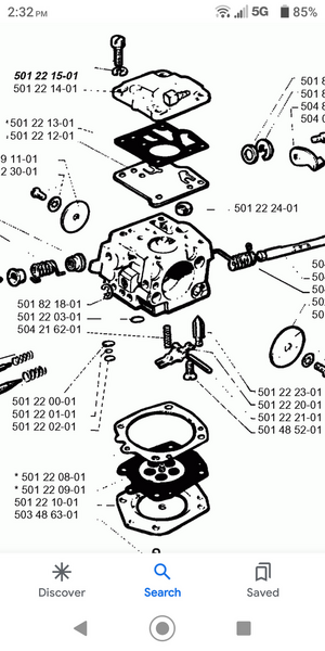

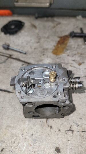

So a little update. I should have said i had actually modded a 670 carb to go on this. Which is no biggy except, the carb had a changable jet like one in pic. Not a welch plug like the other style 670 in pic. So digging through my carbs i found a tillitson carb off a stihl?? at least thats what the diaphram plate was stamped with. So in that carb i found a jet that was not drill with jet, it was solid except for it does have a ball in it which acts as a defusser??? Any how the saw can now be adjusted properly with screw. If your wondering why i used this carb, well is because i did a lil port job and this has bigger bore. 20240203_162437.jpg
