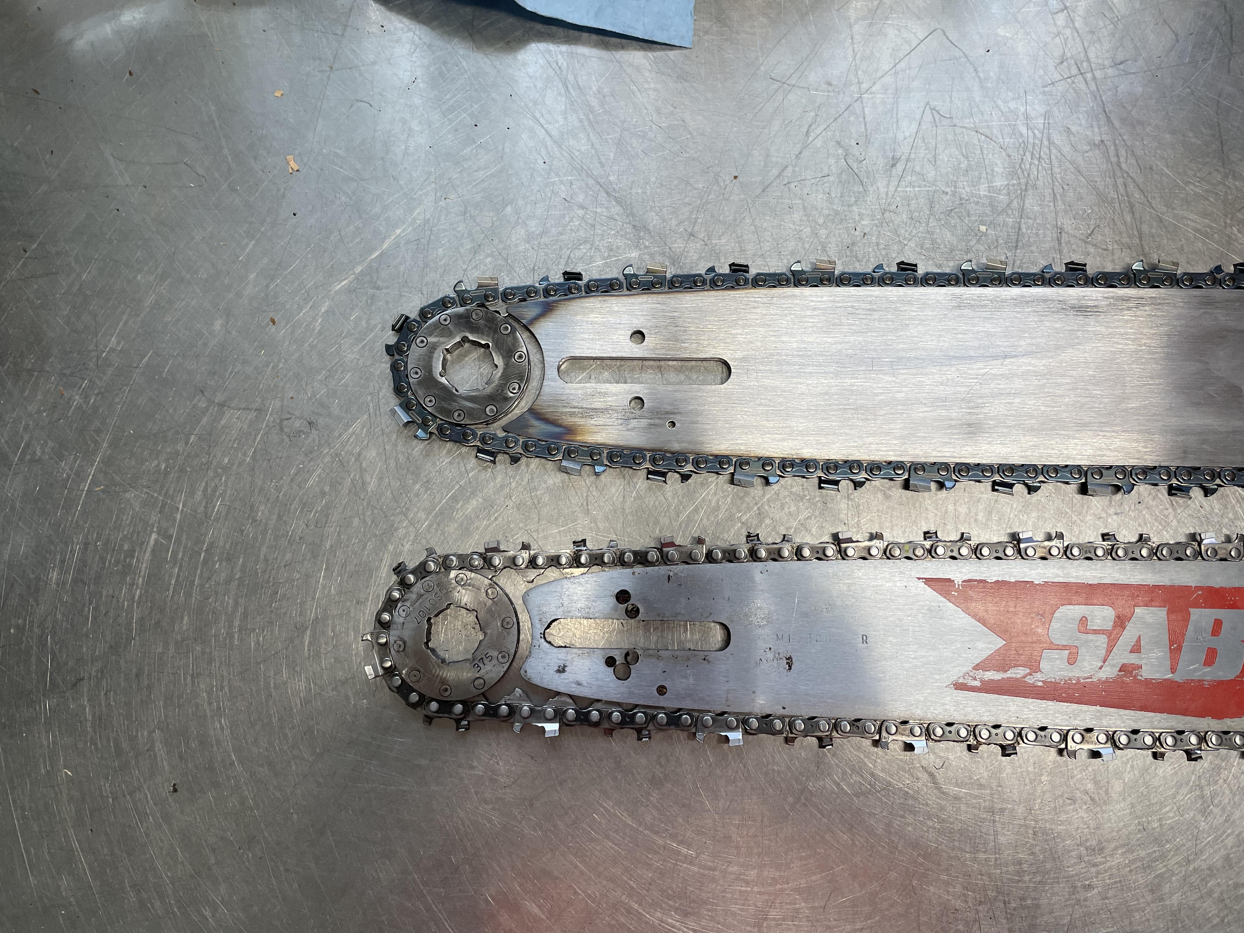

Here is a custom bar I made for a 10t sprocket vs a standard bar with a 10t.
I’ve tried to run a 10t on the bottom bar, it will make the down cut and throw the chain when the cookie comes loose.

You can, but that doesn't fix the problem of throwing chains because the bar tail is just too narrow so drivers are out of the groove.
Makes sense. 10t is two more then I ever ran so I’m outta my league. I though it was just an issue of running out of tension adjuster.
