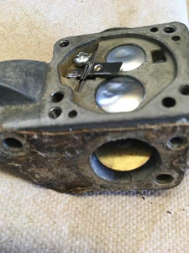

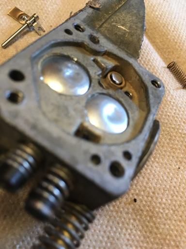

I have run into this peculiar situation from time to time and wanted to know if anyone else has had this experience. The latest project was a Mini Mac with the Zama carburetor. I set the metering lever correctly, put the saw together and it would not pull fuel, it would run on a prime. Pulled it all apart (the only way to access the carburetor on the MM) and found the lever was flat against the body of the carburetor. I then reset the lever, put it all back together and the saw ran as well as a Mini Mac can. Set it down to work on something else for a bit and tried to run it again...now it was badly flooded. Pulled the spark plug and left it set overnight.
Next day it was clear that fuel was leaking into the crankcase so I took it all apart again and this time the metering lever was bent way up causing the flooding. Reset the lever again, and now the saw worked just as it should.
Can anyone help me understand how that metering lever is getting bent and out of adjustment when the carburetor is fully assembled. I don't recall this ever happening with an SDC that has a fork on both ends (diaphragm and needle) but I can't say for a fact it never happens.

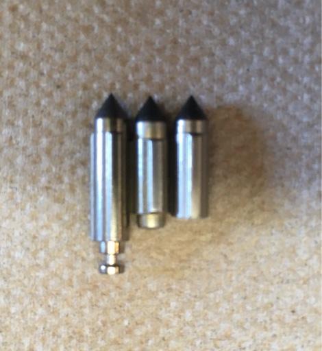

I had a similar problem with a Power Mac 6.
The needle supplied with the carb kit was some longer (center) than the original? (right) I found in it.
I cut off the excess with a Dremel to match.
The replacement required the metering lever to be bent at an awkward angle. Top left.
What it ended up looking like assembled.
The thing is, it’s a Zama. I almost always have trouble with them. Tilleys and Walbro s, not near as much. [emoji43]‍[emoji94]

Look at the "button" on the metering diaphragm, some are different lengths, and some kits do not recognize the shorter length button that presses the inlet lever. Had this happen to me and took some time to sort out. Luckily I keep a stash of all the left over parts from kits and had the right diaphragm to install.

Figured out the carb issue on my PM6 and sharing here in case someone searches in the future they can hopefully find multiple answers in one post.
The lever for the needle stopper was bent up too much so the needle stayed open most of the time. I'm guessing the diaphragm didn't go high enough to let the needle down and close and essentially stayed flooded. Bent the lever to a normal position where the diaphragm would let it open and close small amounts and now it's running as expected.
