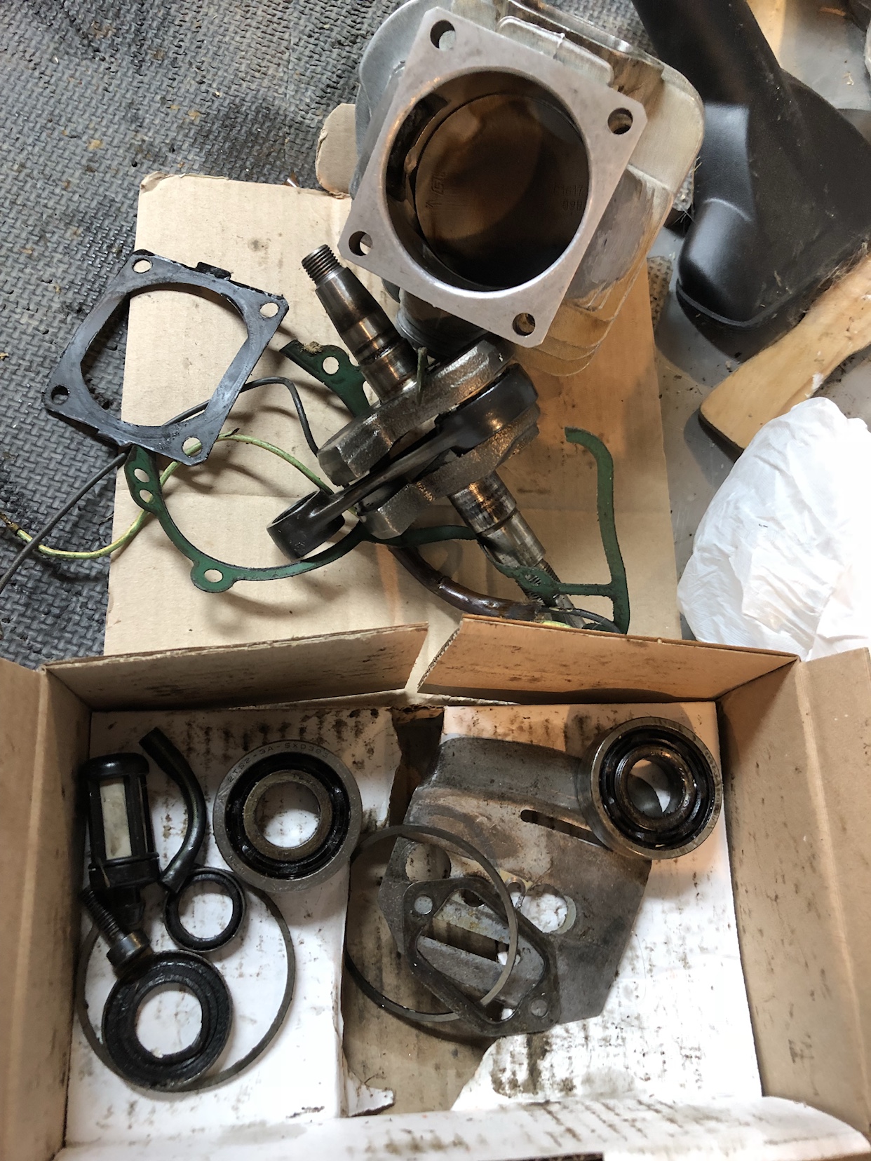

Well here’s the carnage of junk parts from my 066 from this thread. Hey the cases and covers were good [emoji849]Thought I’d share this and then never speak of it again. I would like to thank Scott for cleaning up this cluster&/) and making this saw into what I thought I was getting the first time.
