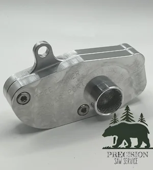

Just picked up a new 2511 and would like to add some accessories but having issues locating a vendor with stock. My list:
1) 1/4" pitch bar & chain combo with necessary sprocket
2) Modded muffler or pickup a gutted muffler. It looks like Echo has and available gutted muffler on Ebay.
3) Bumber Spike
I would prefer to locate from a vendor that can do all to save on shipping but maybe it's not possible.

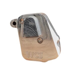

It's the way things are now, plenty of room on the bench in the waiting room. Monkey Beaver may eventually get new stock in for the Panther 1/4 B&C sets. Saw Salvage at the top right of the page sometimes has echo bumper spikes and a non cat muffler. West Coast makes a nice bumper spike for the small Echoes, if you can't find the OEM Spike. you will need to get the appropriate metric hardware for either spike choice since it isn't included with the spike.
