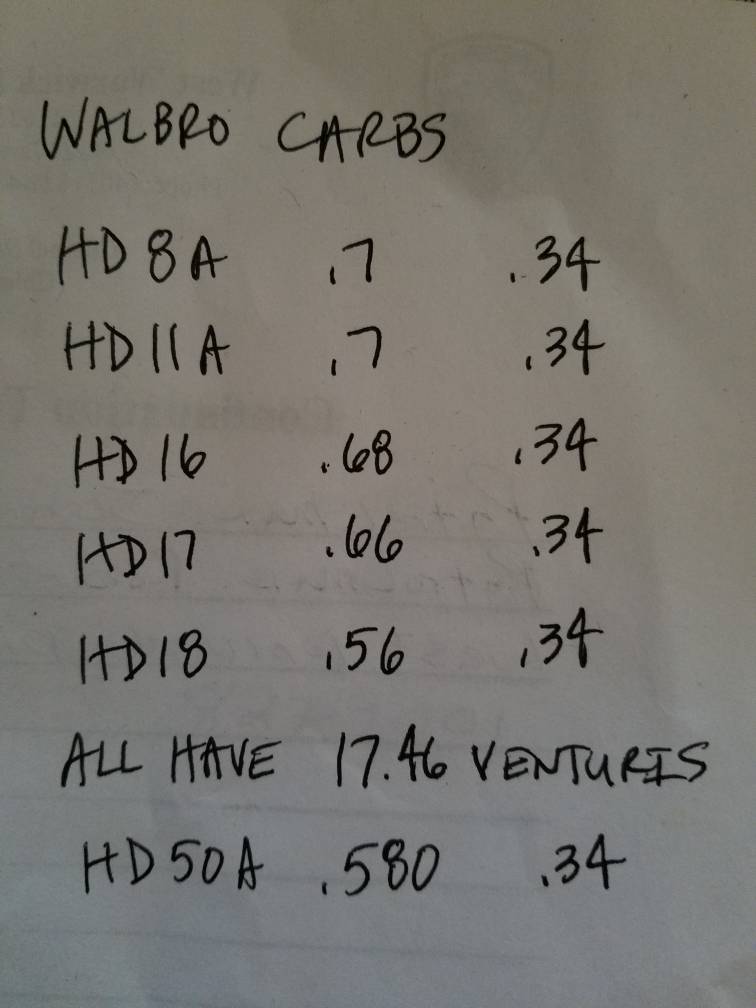

Information I got through Walbro.
Sent from my SM-G930V using Tapatalk

So, what is the difference between and HD-8 and an HD-11? What did the HD-8s come on???
Is the HD-8 the HD-11 w/o the arctic heating stuff???
RI Chevy
3:43 AM
1254
May 7, 2016
27,002
67,761
earth
The guy at Walbro that I spoke with could only give me statistical numbers. He did not know the different nuances between them. He did state the higher the number rhe newer the carb. I gotta try ans call again and see if I can get more info on these.
