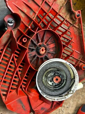

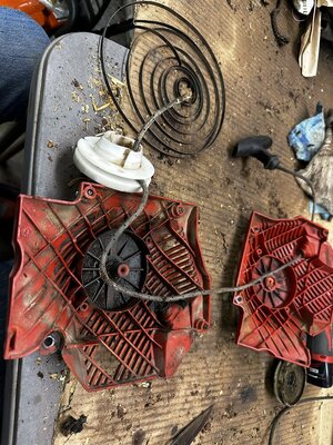

I just got a 2186 with 390 cyl ported by @Stump Shot from @thinair. Strong saw but I wanted an unlimited coil just for ease of tuning. While cleaning the 2159 that brought me to this forum years ago I was reminded that the coil wire was too long…reminded me of @Spike60 coil college thread. So…I swapped the coils, got some kickback and broke the starter. :-( coil used is 5371621-01

Sounds like that decomp you wanted to put in didn't come soon enough!
Maybe the saw would like a 372 coil better.

Could have sheared the flywheel key as well. The motor enjoys much more timing advance than the cylinder base or recoil pulley will handle 🫤
I was disappointed to find the plastic starter pulley. I thought this chassis stepped it up.

...and like we discussed, if the plastic engager thingy had some wear on it, it didn't have a chance, even a stock 372 will blow them up.

Would be nice to get a nicer starter and air filter cover for it eventually. I don’t mind rough stuff but the rest of the saw is pretty nice.IMG_1162.jpegIMG_1165.jpeg
