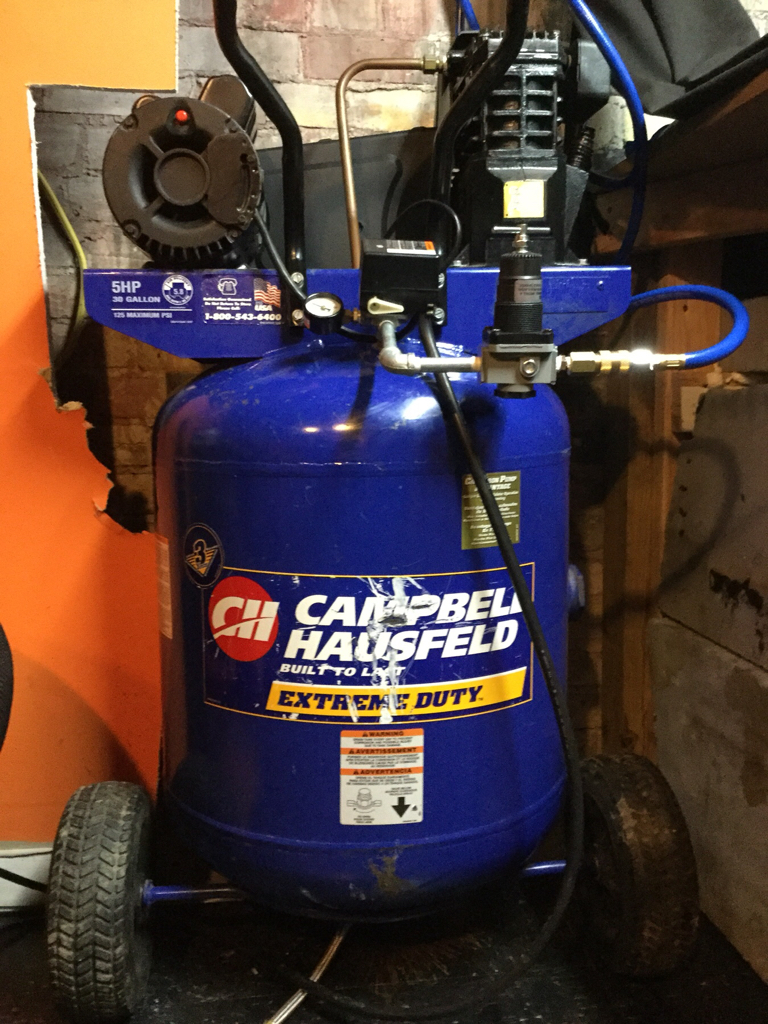

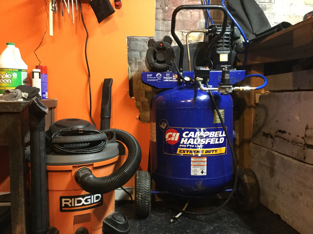

It’s come home with me...
A minor breakdown with my craftsman pile of junk sent me to craigslist.
Thinking about an expansion tank once I settle down in permanent lodgings, but for now..
She’s a million times quieter and way more powerful.
Awesome!
Sucking and blowing corner.

Very nice, that is about the type I would get if I go shopping for a new one. Recently I plugged all the leaks in my ancient compressor with JB Weld. To my delight the repairs are holding strong and my air tools all run much better now. Ready for another 40 years!
