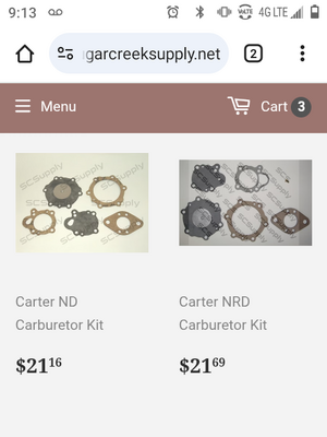

I acquired another C50 recently and have given it the treatment. Runs on prime but there was an issue with the small brass eyelet that forms a seat on the fuel pump check valves (Carter NRD). Like the others, runs on prime.
