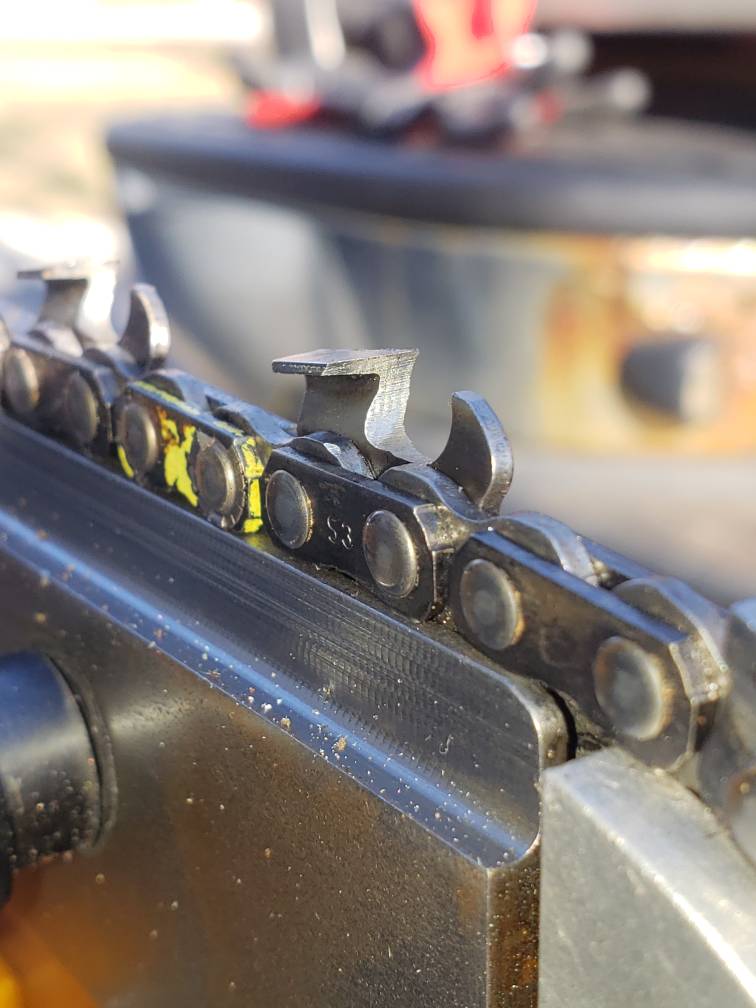

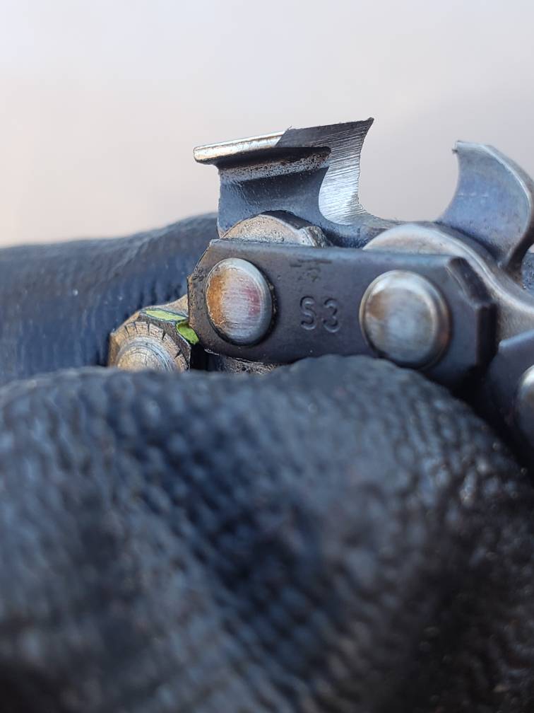

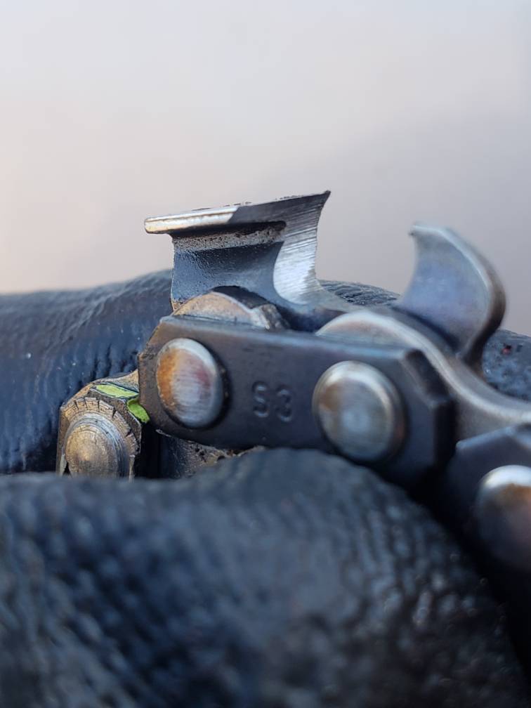

OK. I experimented last couple of weeks. I think my .325 chain cut best using a 13/64 file.
Really loads up the saw much better.

Through my testing I did exact same thing you did. I found the cutter with larger hook cut about 3 seconds slower in same piece of wood. I went back to 13/64 file and got the 3 seconds back.

I was cutting 16" hard maple round
RI Chevy
8:46 PM
1254
May 7, 2016
27,002
67,802
earth
I cut red oak with the cutter I posted above. Cut pretty good.
I used MOFO 026 with 18" bar.
