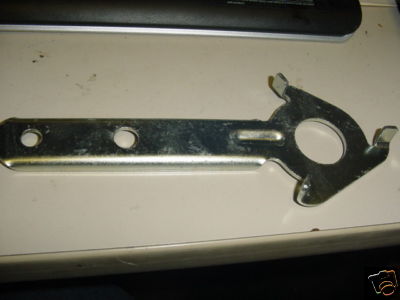

I might have figured ------
Looks kind of chinchey to me .
I have to agree with that. It looks like a toy.
