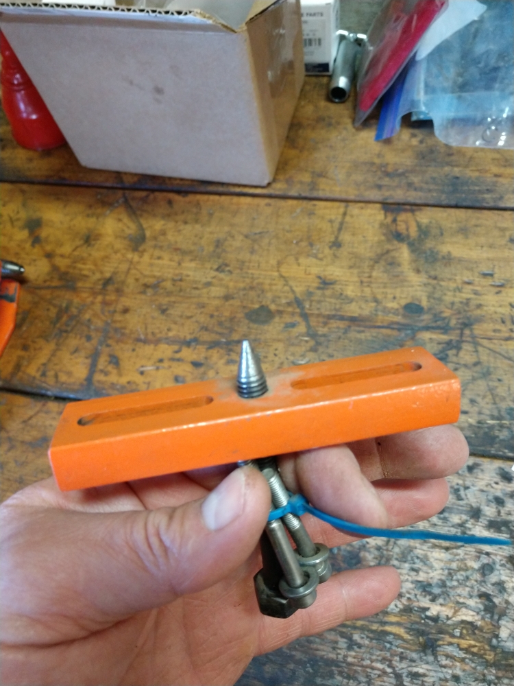

This works good on huskies. Made it on the mill at work but it could be easily made with a drill press and a little patience.
