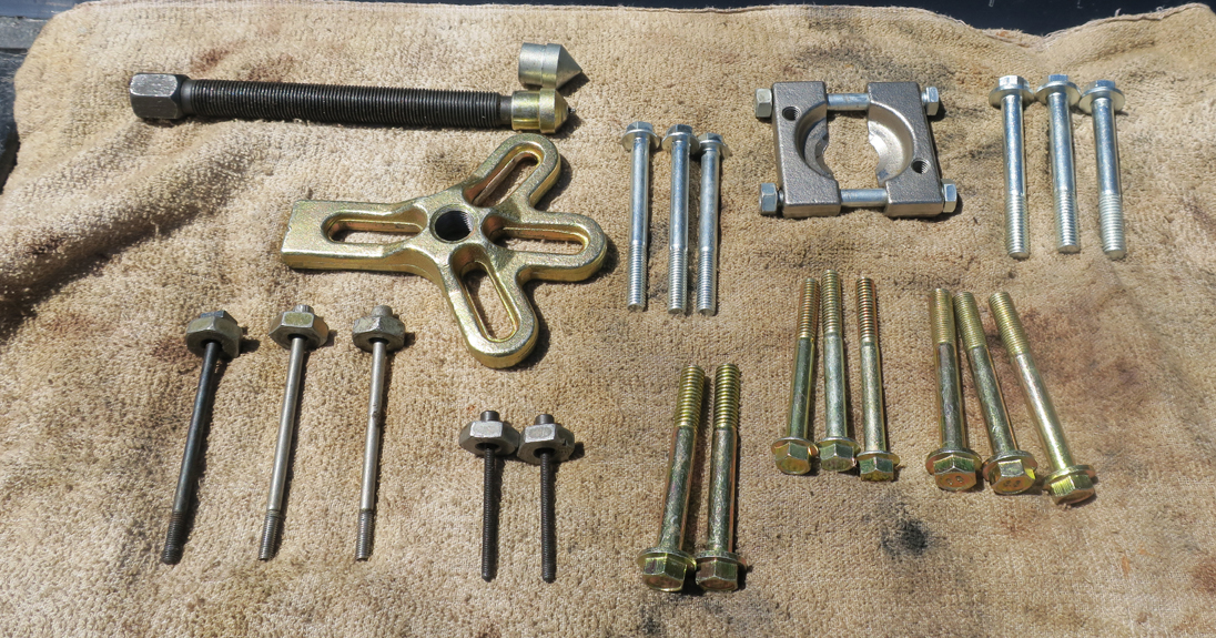

Took the first of the 266s out to the shop for a sample to make a puller since I couldn’t find mine, and weld the case. I sucked the centers out of the first two washers cuz I made it sloppy and then busted the head off the set screw center bolt. Wow. Lots of heat, tapping, and Kroil. (How much heat is too much?) I used the old method where you smoke, soot the offending part first and then only heat until it burns off. I didn’t really need to pull the flywheel, at least not now, but I wasn’t going to give up.
