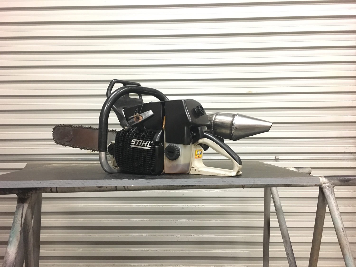

Looks good!
No stinger on that pipe?

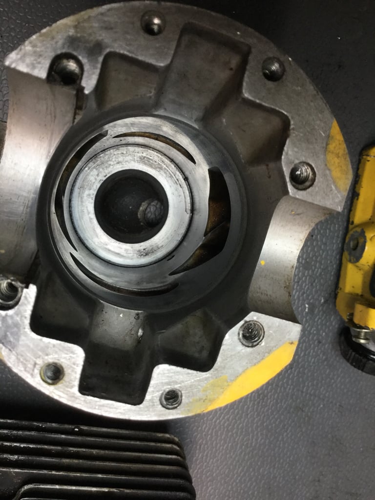

P-60 piston after some cleanup.
I’ve found a chip and some gouges.
And the piston ring grooves look pretty carbonized.
After some rubbing with 400grit and red armor,
The scoring has gone down a bit.
Pin is really carbonized.
The jug has some cuts as well

Pro Mac 850’s jug.
And piston
This is the farthest I’ve ever taken down a saw.
I’ve been reading as many build threads as time allows but I’m no expert.

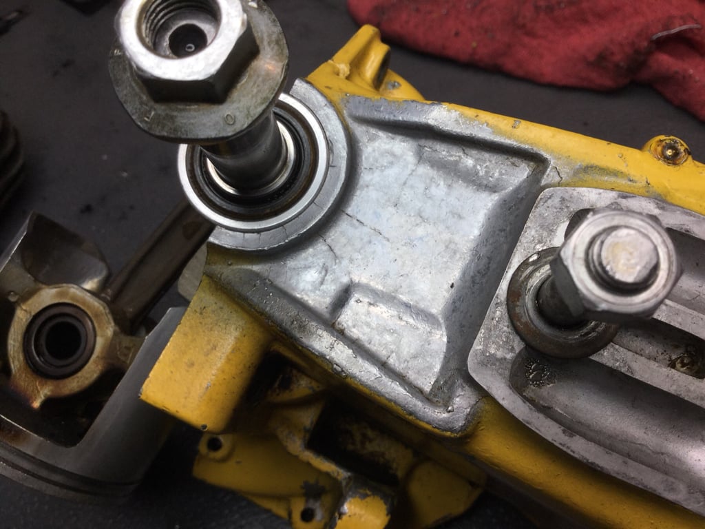

Also I’m wondering about the cracks on the case/oil tank.
What say you ope?
Im not a pro but no one else is answerin u:D im a newb too. I see scored, cracked, and transfered. Wondering if u wanna go fishin tomorrow? Bet that thing will hold a 18' boat in a swift river:p heres ur grain of salt:D hope someone can help u tomorrow. That thing is a beast of a motor! Be a damn shame if its toast. Hope i got ya chucklin at least:godsdrink0nw:

Has to be the nicest factory squish band I’ve ever seen.
