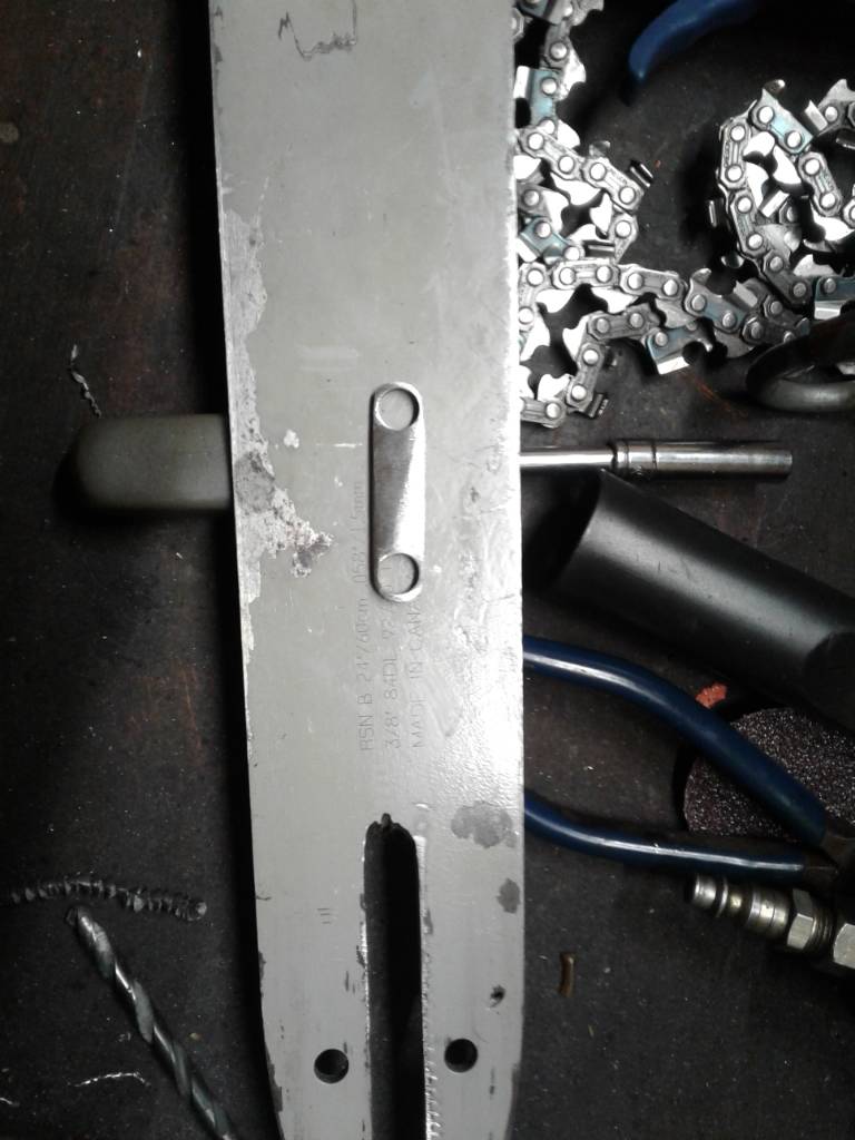

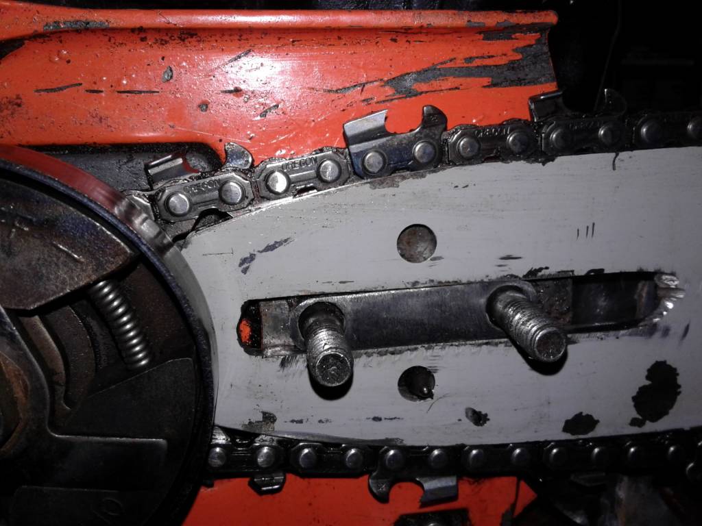

Made an addapter.so i can run the stihl bars on the husky. Saves me buying a new bar.

I got a silly question, if you just wanted to run Stihl bars, will Stihl studs fit in there, or are the thread larger?
I like putting Stihl 460 studs in 660s and 046s because the boss for the bars are larger. Chain covers have to be swapped or modded, easy to do.

Husqvarna studs are pressed in, no threads.
