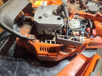

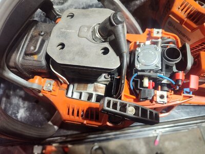

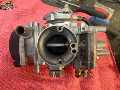

Currently on my workbench: a reed valve block for cylinders with a round intake. The base is currently a Husqvarna 372. However, the block should fit many other chainsaws or be adaptable. There's still quite a bit of work to do.
The reason for reed valves?

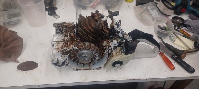

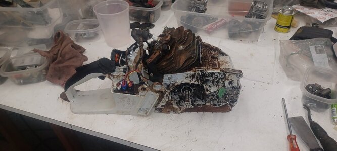

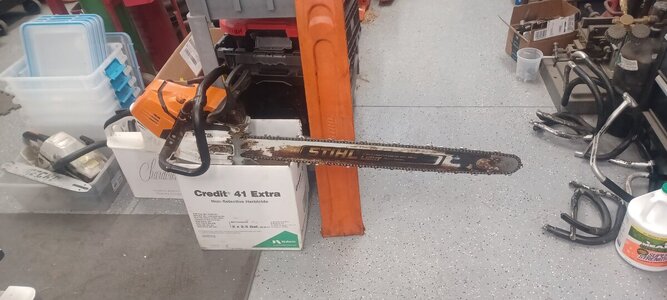

Ms400 on the bench today. Low compression
Follow up:
The owner of this saw said it was running erratically a few weeks back. Compression tested good, pressure and vacuum good. Pressure tested the carb and it checked out. I don’t work on m-tonic too much so I suggested maybe we try a new solenoid. Replaced the solenoid, put a bar and chain on and made about 5 cuts. I didn’t bury it to the dawgs or anything. Sent it on back.
This week he says his guys ran it for a while and it shut down. No compression.
looks like a piece of the piston/ring came off eventually.
Currently stumped on a diagnosis.

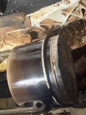

Here’s the damage:

No air leaks before you tore it down?

The question is this: Did the ring break before or after the other damage? It looks about like there is some damage from pre detonation, but maybe that’s all debris damage.

Yeah it’s definitely got an air leak around the base gasket flywheel side. Just wondering if something maybe blew up first
Is there any carbon/gunk build up under the rings? I wonder if there was then its possible it would not let the ring retract all the way allowing it to catch on an opening and snap off the bits.

I don't think it's a leak that caused the saw failure, now I only know about the pictures that have been posted, but the damage to the piston ring has been there for a while, carbon build-up there according to the pictures.
I also don't like so much soot deposit down the piston....
Of course it could be that it had started to have an air leak after you measured the p&v, but this chainsaw was well on its way to breaking down, with or without an air leak.

With that much blow-by and for so long I’d think both rings were stuck to some extent.
