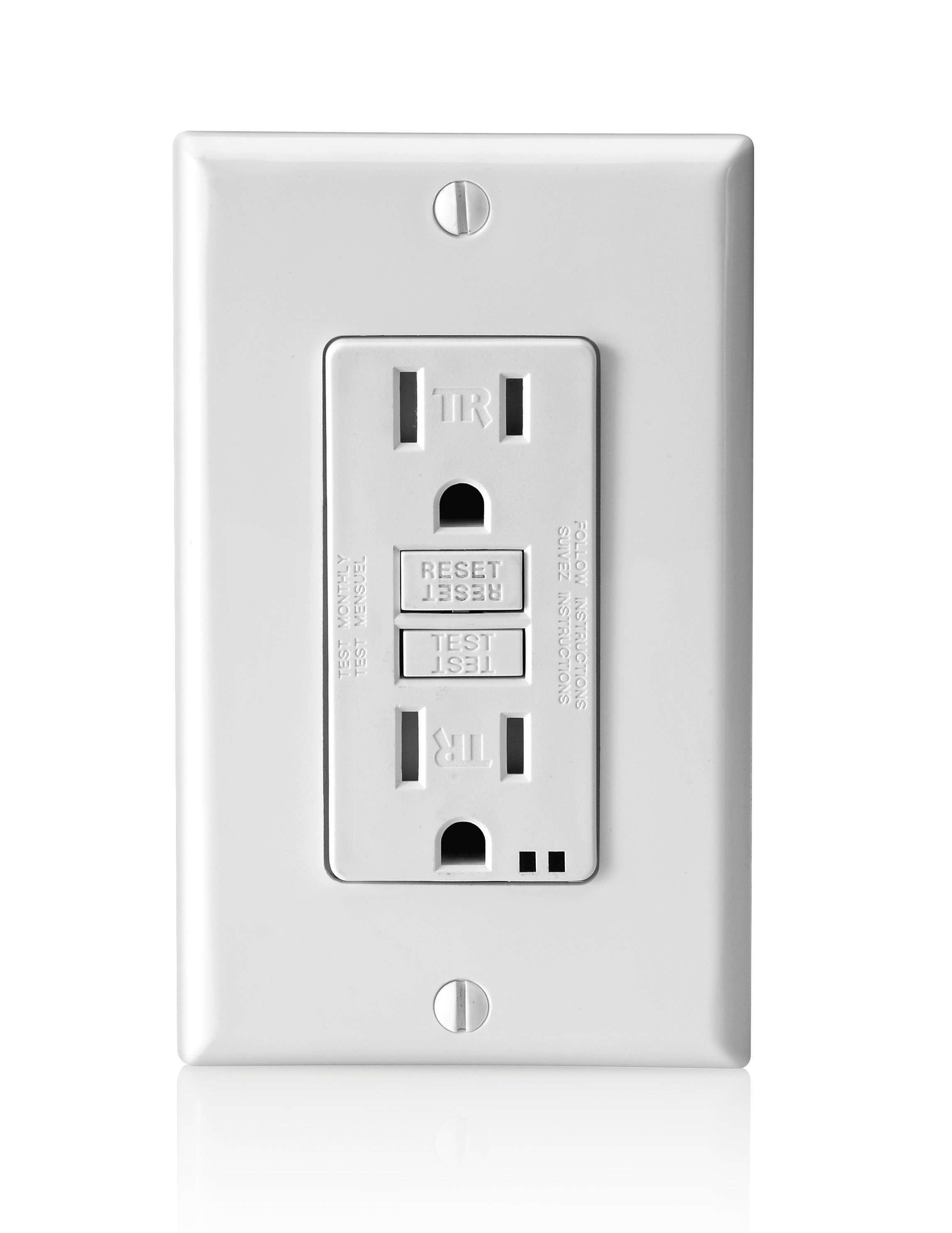

last I knew, the NEC has never specified which way is "correct"...maybe a local code, but not NEC...
GFI receptacles have the test and reset buttons lettered so they read with the ground down...
whatabout ungrounded appliances?...wouldn't matter either way...
more personal preference than anything...but I will flip em over fer you today to make ya happy!

It's GFCI and any new one will be labeled for installing either direction. Although, I've checked the code in my area and there is no mention on which direction is correct.
I've installed them both ways and there is a downside to having the ground plug up, all low profile plugs have the cord coming off the ground side. So now your cord is going up the wall.
