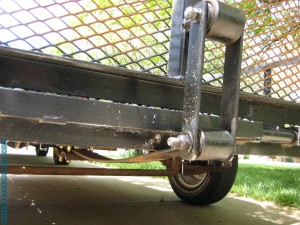

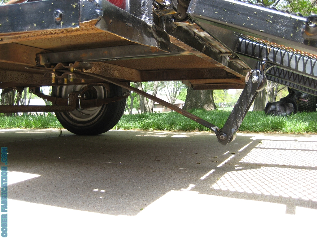

plan for now is to man handle them....i have a couple small springs I am going to add to help but if the ramp ends up being more than i want to manhandle i can either do a split gate or add some other kind of assist. typical tailgate assist like pictured below wont work because there wont be sides on the bed, since this is a ranger i can only go 72" or so wide with the bed and 72/84" deck widths are fairly common now i need the decks to be able to overhang the side of the bed.
