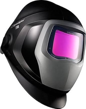

How can you hate a Speedglas hood? It's by far the best welding hood I've ever used.
the best automatic helmet ive had IMO is an old Arc One, Vision helmet with industrial 540 7-14 shade lens...I still have it, but the lens is junk! it had a few thousand hours on it, so its expected... they still make them but the helmets are flimsy now, ive been meaning to buy a new lens for it, but I have a new Jackson 9-13 shade that ive been using...
I hardly even use an automatic helmet anymore since the ArcOne has been down, just a regular ole Jackson fixed shade (gold lens)
the speedglas I have, my work bought me (without asking me) I used it for a couple days, and hated it! I cant stand the shade 5 "windows" in the sides...its distracting, the way the lens flips up the spring it uses isn't all that strong and it tends to "open" when you weld out of positon with yer head pointed down, then theres the proprietary cover plates ...no thanks!

The Speedglas has plastic curtains you can install to block out the side windows if you want. I personally like them but I don't have people welding next to me. I can see how someone sparking next to you would be a nuisance.
Their older head gear didn't have a great bottom detent and would open up a little if your head was pointed down. The newer one is better but it still can open up if you tuck your chin and hit the hood on your chest. Lets face it, blinks are mostly for bench work and fab shops. When you're welding all day a fixed shade would be better on your eyes anyway.
Here I found a helmet that might suit you.

i wasn't talking about the whole helmet opening, im talking the lens opening like to use it for a clear face shield...the bottom of the lens will fall away from the helmet letting light in when pointed down...maybe its just mine? idk? i'll never use it again!
