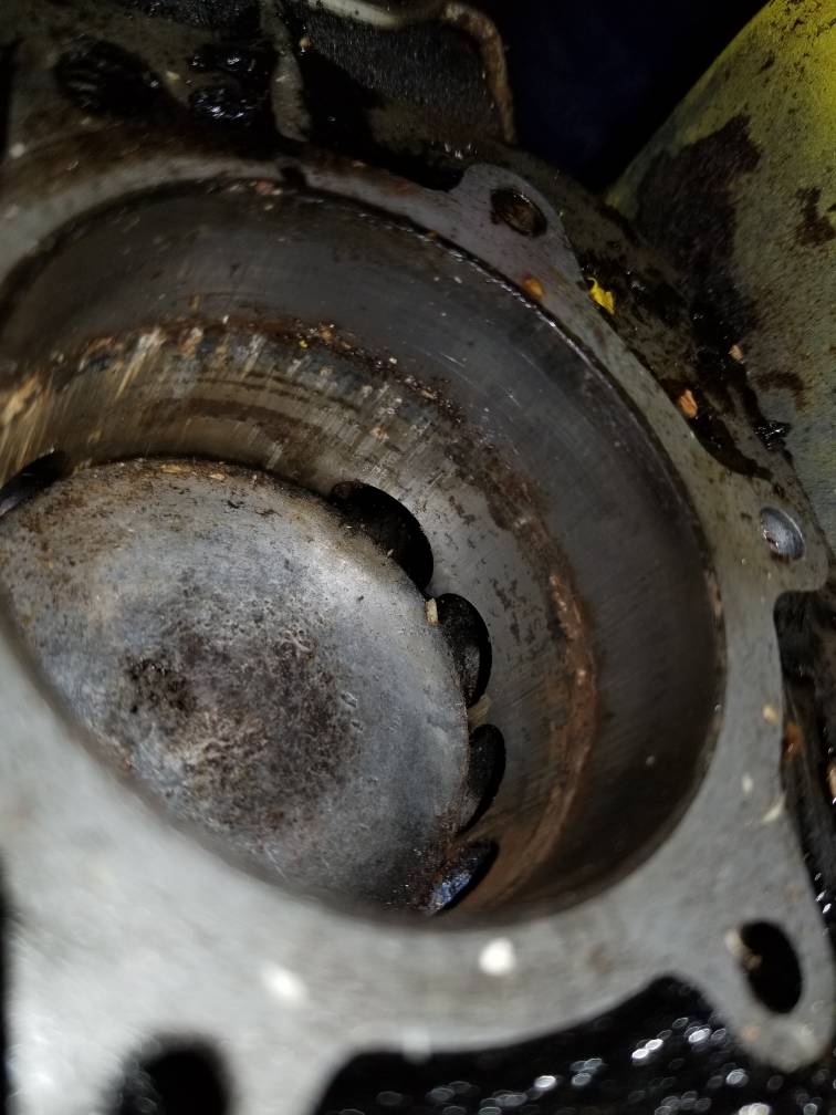

Well i got it freed up tonight. Does look like some light scoring in cylinder. Hope it will clean up. I cant see how the cylinder comes off. I gotta clean some more of the crud off so i can see better.

Not real good pics. Took a wire scrub pad thing to the cylinder. Looks like it has some scoring. Whats the best way to clean this up?

If you got as much out as you could and the cylinder feels smooth, run it. They always look worse than they really are. Any little residue will come out during use. Clean out the ring grooves, oil everything real good, put it together, start it.

That cylinder looks better than most I have unstuck. Should run fine. I like to use seafoam to unstick rings. About the only thing I use WD40 for any more is to clean and shine up the plastics on customers equipment and a little in the plastic bags I put sharpened saw chains in.
