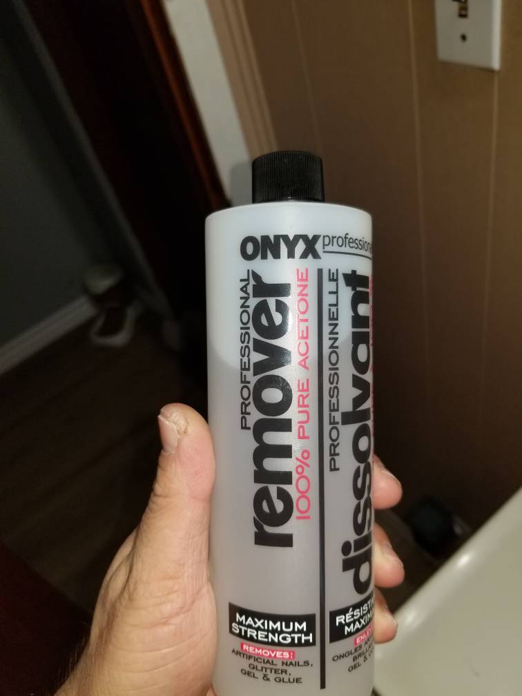

Needless to say, but be careful with the open flames near the acetone. Highly flammable.
One of the guys on the boat forum was using a kitchen mixer to stir epoxy. He later cleaned it in acetone.
Accidentally switched the egg beater on and insta-fire in the boat. Luckily he had a fire extinguisher nearby.
That'll ruin your whole day right there.

Will this acetone work? Its what wife uses for nail polish revoval.
Don’t let her know your have taken it though,or the piston won’t be the only thing seized up:risas3:
