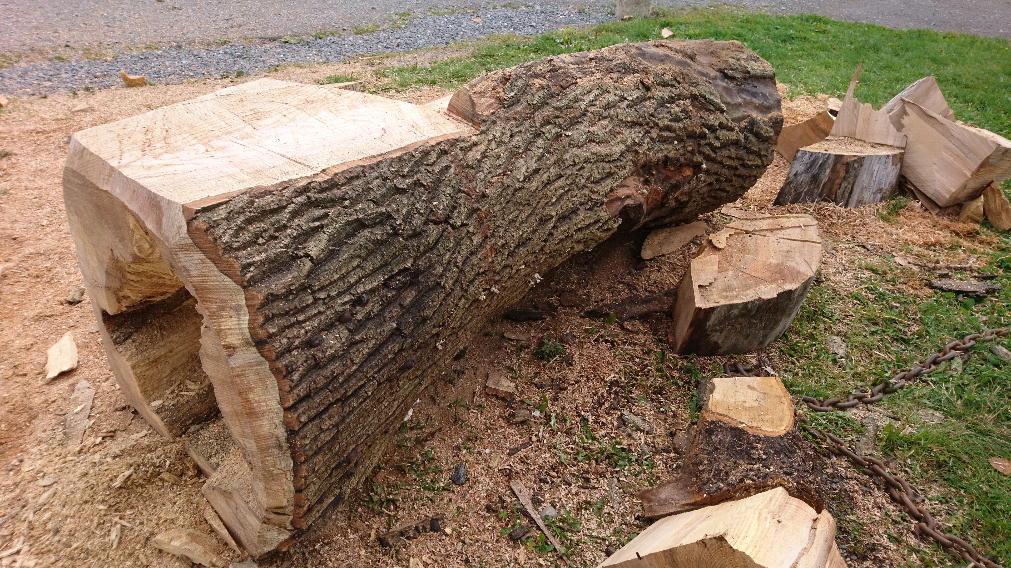

Yup. Just cross cut deep as I dare every foot so the chunks don't get too heavy. Then match it up close enough so not to gouge it all up, using wedges to remove the stubborn bits, and just carve away with a saw until it looks like an elephant...er bench, I mean. It's bigger than it looks, too. See if I got any other pics here...
OK, found one:
The trick about carving is being patient and using a dull semi chisel chain with an easy touch.

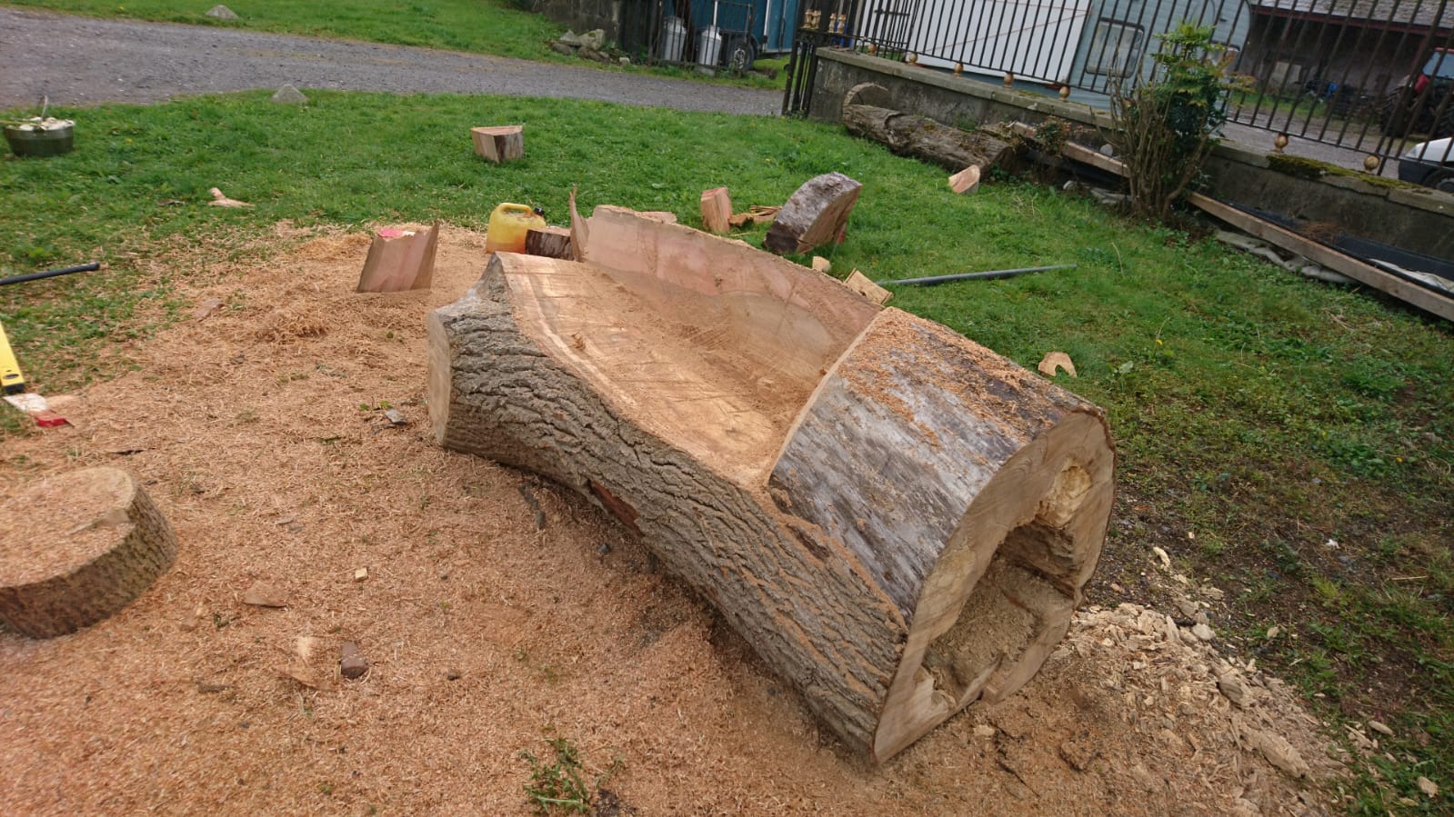

Regular bar and chain? Or carving setup?
PNW carving style:
That's right before I trued the bottom so it would sit solid. I'm eyeing it for levelling.
So a lil ms391(mildly massage by me) with a 30 and 24 inch bar and also used an ECHO 361 with a 15 inch bar.
I sold my 044 and 288. Thank god, coz they woulda killed me doing this.
