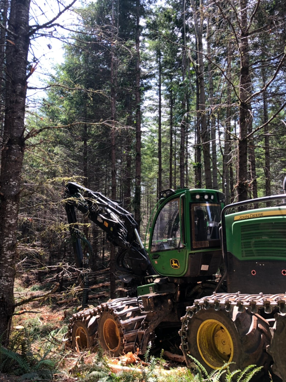

Before
After one more day of cutting and this job is wrapped up
Unfortunately at the time my 12 year old son could drive one of these like he been playing a video game up in orbost Victoria.
He just does not get saw skills ......
