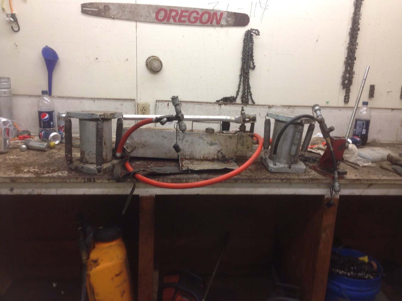

Many
It would be nice if they were still around.
Those Jack's are homemade I am 90% sure.
Really fast setup you pump on the up stroke and down stroke
My old set

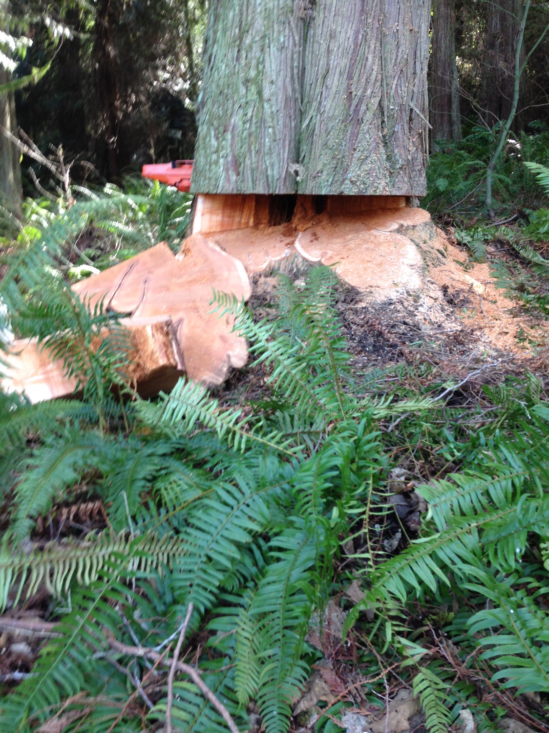

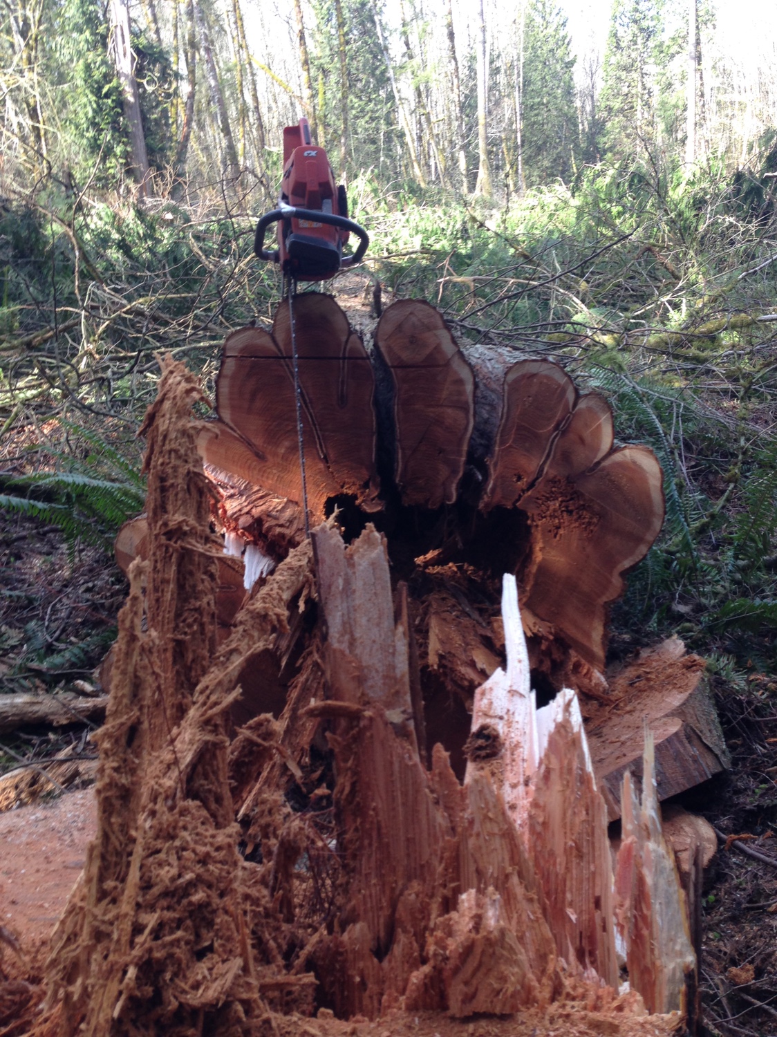

It’s a block face with a humboldt on the stump. The biggest benefit to using a block face is the butt hugs the stump longer because the hinge wood can bend vs snap straight off.

Why do you guys call it a block face? ... Because it has a three face undercut (resembling a block ) or because it' blocks one side? Or would you also call a Humboldt with three faces a block face?
Or did you stuff one side?
^^(That is not a Humboldt technically with that angle...as you referred to it as; with a block face )
If we want it to hold then we aim and do the three side undercut either with a vertical bore or take a few saw kerfs out.
That's your basic "Jonny hold me tight"
You can bore through the back and preset you holding wood to overcome a side lean for extra insurance. What were you actually doing there? What you guys call a sizwheel? So you were pulling it?
Because you have a gap so then it looks set up more to 'boot' it over (bounce) more so than pull slide & twist. That case then it can't peel down like a tongue but peel up like a bandage.. although in the right direction if that's what's intended. Maybe it was the angle of the stump you were after mainly.
If you want to pull, boot & twist that
F—ucker then make a post on your pull side with three vertical bores.
Looks like you are in between ? IDK?
Opinions.. theory's ? Like azzoles,,. everybody has one eh?
Nice flush cut. It's perfect.
Looks like being fourth generation of loggers has really played off. Respect! Your cuts are always wicked,
