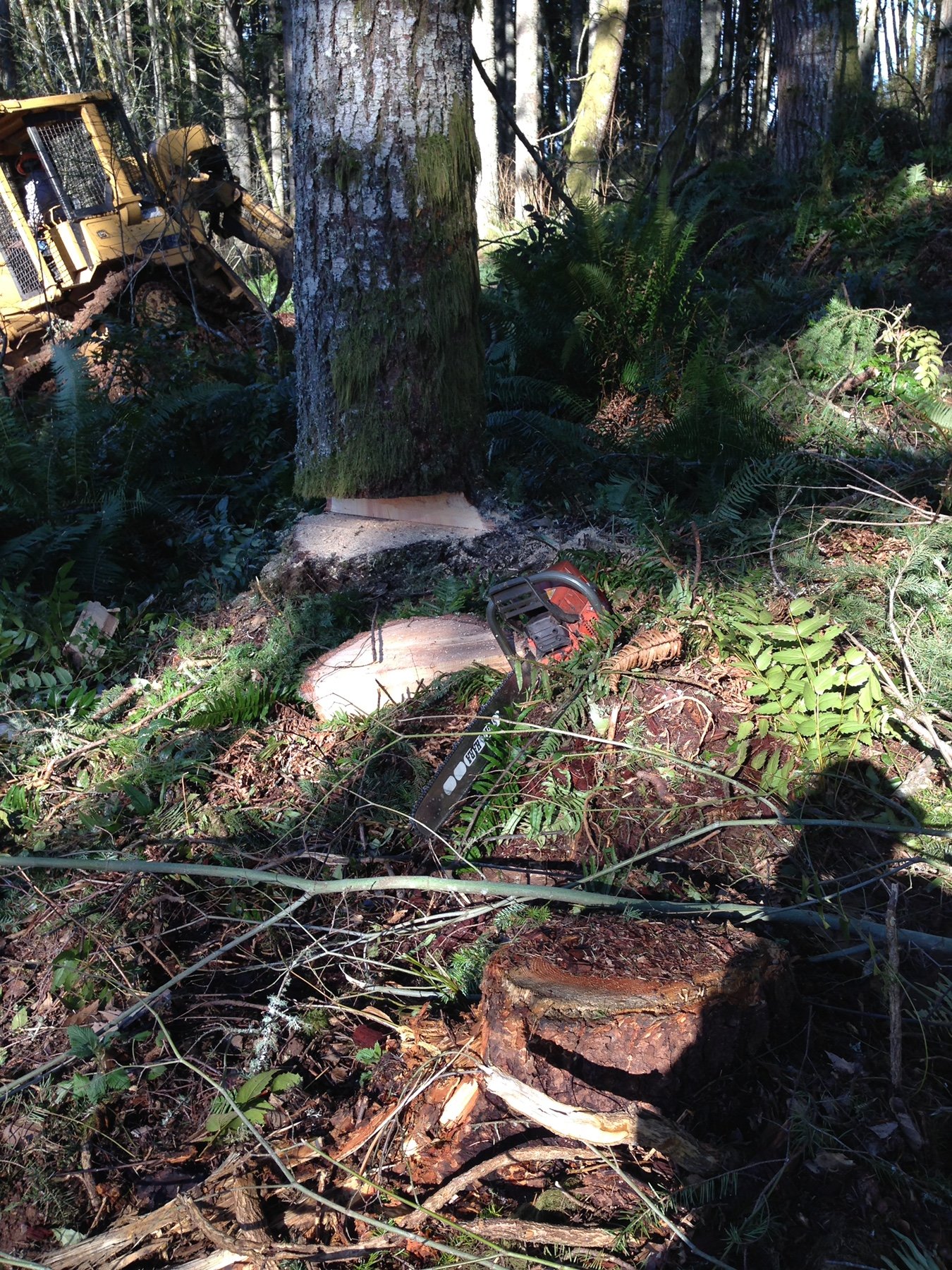

Why did you use this type of face cut; what is the benefit compared to the conventional cut? I've never seen this in any "how to fell a tree" manual.

It’s a block face with a humboldt on the stump. The biggest benefit to using a block face is the butt hugs the stump longer because the hinge wood can bend vs snap straight off.

Does that "damage" the log at all? As in split or crack the trunk?
I can see the advantage to help steer tree.

That cedar was rotten when it came down the first 25’ or so from memory collapsed in on itself. Most of the time a block face won’t do any damage to the butt logs.
