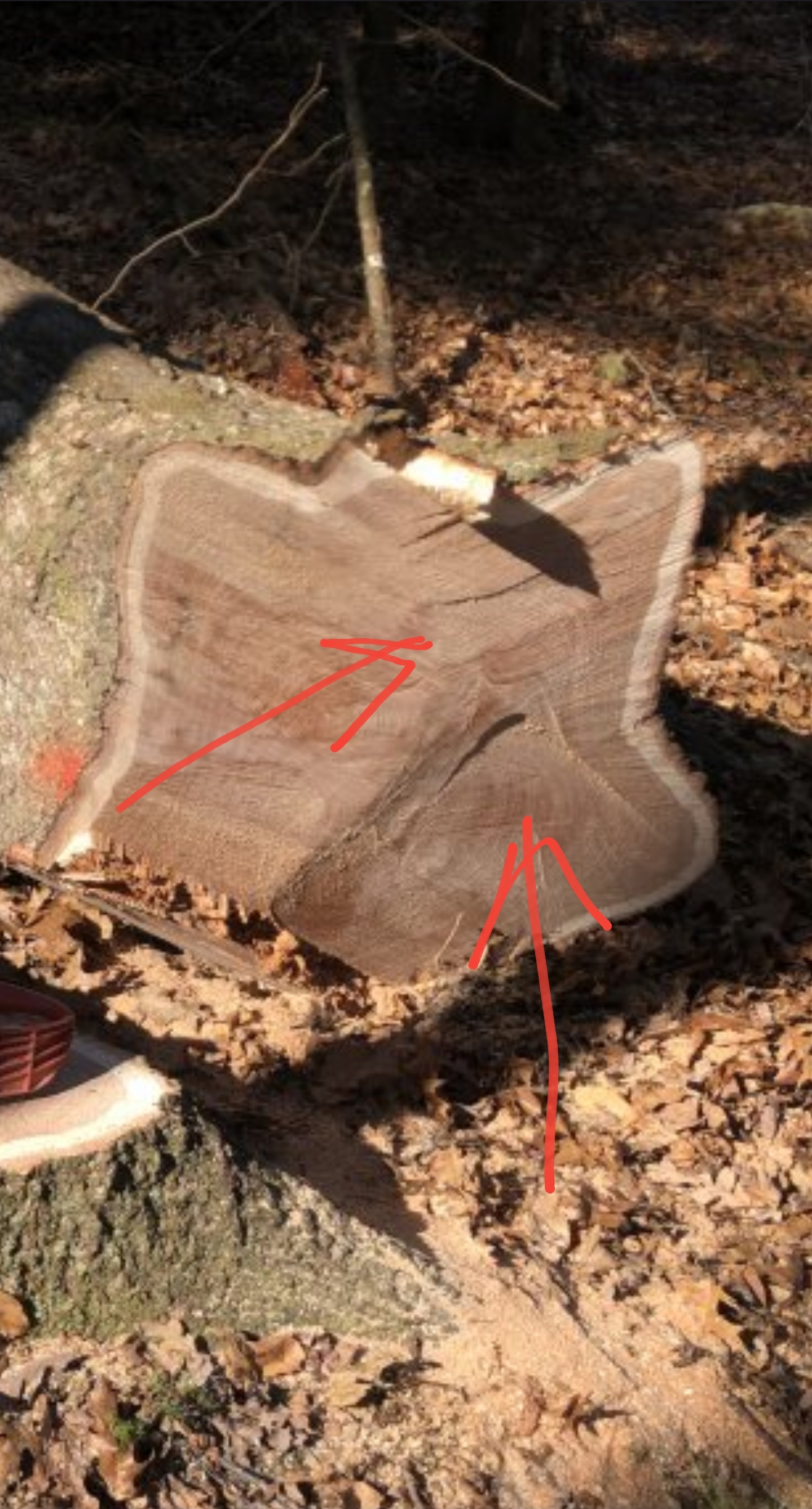

I dropped this tree today for a buddy. I had to wedge it over it’s back lean. I only had to worry about getting it to fall where it wouldn't get hung up and it was solid at the stump for the most part. One side faced an open field and I was able to push it that way. Its the biggest tree I've taken down in decades.
I ended up limbing it and bucking it with the 7910. That saw got heavy, so much so I was thinking about smaller ported saws. A shorter, light bar is definitely in my future.IMG_4351.JPG

Did you plunge cut and go around the base to make your back cut?
I’ve seen guys fall big trees with short bars, but never with a stump cut so level and even.
Nice work!

Looks like plunge cuts at the red arrows...
