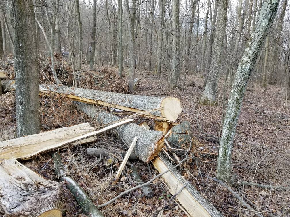

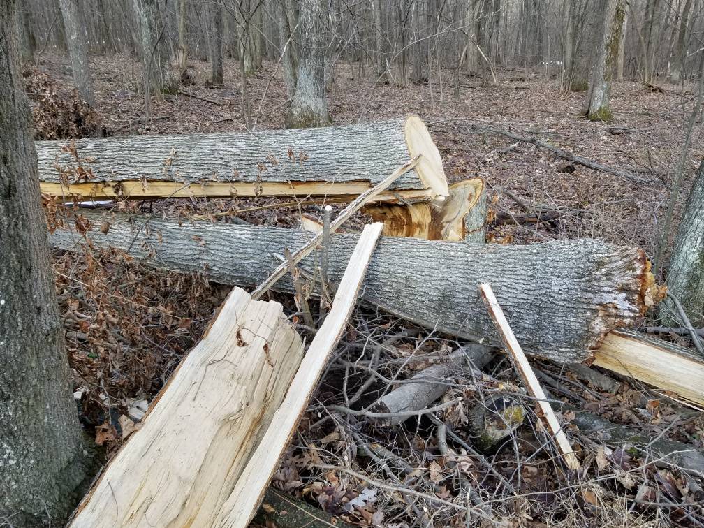

I agree Heath. I do not understand the slope on that cut ... back to the face.
But I am a simple guy. Not a feller.
I personally would have used a bigger bar on the saw to drop that tree.
Looked to me like he cut his holding wood when he was making the cut behind the right side of the jack. And then the the tree went left.
No the fibers broke at the root Kevin on the 'safe side' (The tension side) Possibly going a bit punky at the root? Fibers look odd but maybe just from the stress break?
He cut the middle out and possibly some tension wood with it. He should have lead with axe and both wedges on low back side instead of chasing only. You get an upward pressure with a jack on a small tree . Not a lot of room from the hinge to the jack point. Wedging is ' different mechanics' the way I see it.
(Depending where it's wedged from.
The wedge is almost
always going to be steeper than trunk angle once it starts so its only forcing in with outer edge contact.
If not more high side holding wood then different techniques were needed.
Not sure why he is using the jack?

I don't know why the hell he was jacking those trees in the first place. Didn't look like anything a couple wedges couldn't handle. Piss poor technique imo.
Hard to say without being there judging the tree. But I agree, for the amount of jacking required to push it over it looked like wedges would’ve done the job

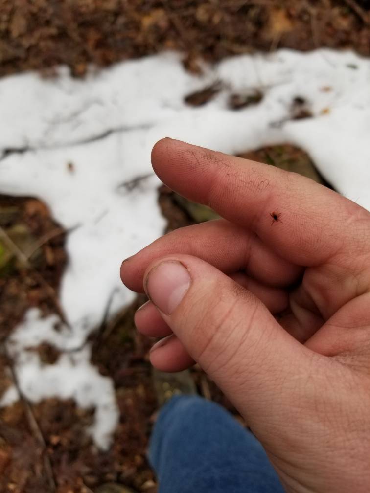

That's the first time I have ever seen one in a real picture. Only seen a blown up illustration before in my first aid book.
Mind you I think I have them in my head every year. Everytime you bump your head and forget about it and you feel a scab a few days later. Or buddy threw a full unopened beer at me and it broke in the centre of my neck just below the base of the scull where my hard hat strap rides. It flares up all the time. My first reaction is "its a tick". That only has been tormenting me for 25+ yrs.
There’s many reasons to jack over a tree, how many of you guys have done poles? Or other super high value sticks where every foot counts because it’s a marked tree? Jacking is an art you normally go 1/3 to 1/2 way with the face after you put the seat in.
If you look the face is about 1/2 way in hinge is probably 10% and this is red cedar a super soft wood that pops off a stump.
