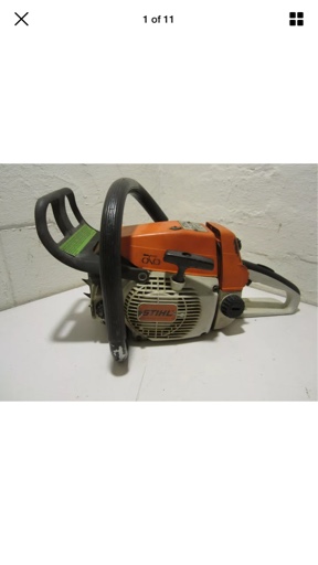

Wow nice saw and a factory wrap handle![emoji39]
Yuck! Cylinder doesn't look too bad though?However, I think someone tried to use motor oil as mix....

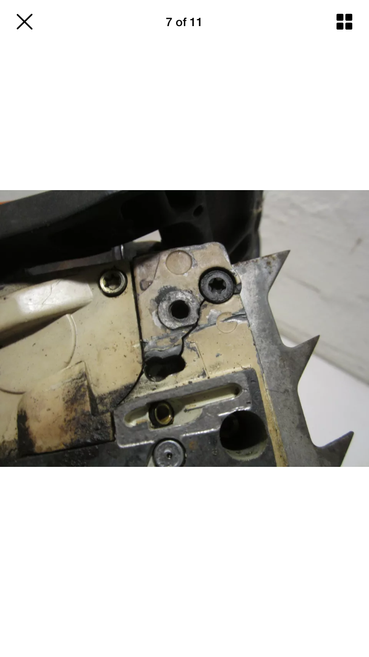

Is it through the plating? Hard to tell in the pic.This is a mahle cylinder. I have started to clean it up...but I think that will be a waste of time. One good(or bad) gouge above the exhaust port.
Yes it is. It’s pretty deepIs it through the plating? Hard to tell in the pic.
Damn that sucks!Yes it is. It’s pretty deep
Looks more like they used waste oilHowever, I think someone tried to use motor oil as mix....
View attachment 208190 View attachment 208192 View attachment 208193 View attachment 208191
Found that they used old oil for bar oil....case gasket was leaking.Looks more like they used waste oil.

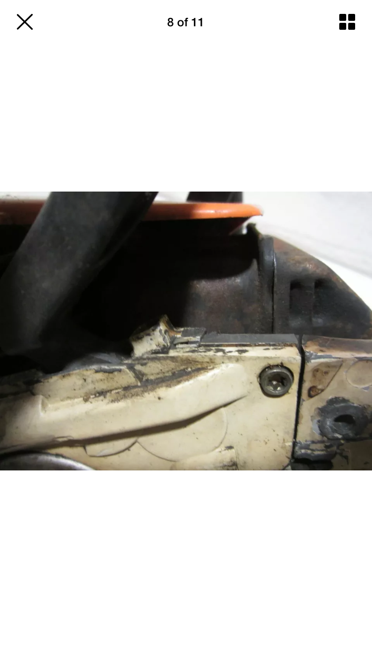

Won a 024 on eBay.... had the beer goggles on when bidding, didn’t see the broken case. Oh well, I’ll prob part it out. I’m not in it too bad, thankfully.
I can smell a 660 jug on it.This is a mahle cylinder. I have started to clean it up...but I think that will be a waste of time. One good(or bad) gouge above the exhaust port.
That makes sense.Found that they used old oil for bar oil....case gasket was leaking.
