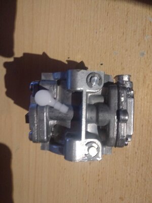

Hello guys, bad news, the carburetor arrived yesterday and today I assembled it and my machine does not start, with the original carburetor the machine started but it drowned and went badly, that's why I looked for a new carburetor, but with this carburetor it didn't The machine starts up and when it starts up it stays on for a few seconds and then it turns off and doesn't start up again and that Tillotson, no Chinese copies

Is the impulse port plugged up? Will it restart on choke?

The HT 12E carburetor was used on the 088. The HT 7A would be the right one for the 084.

Yes, that's what I'm seeing, no HT12E is valid for my machine, the 084 works correctly with none of them, although on the outside they are practically identical, I have located several here in Spain but they are second-hand, and it scares me that they won't. They are in good condition although the seller indicates that they are.
