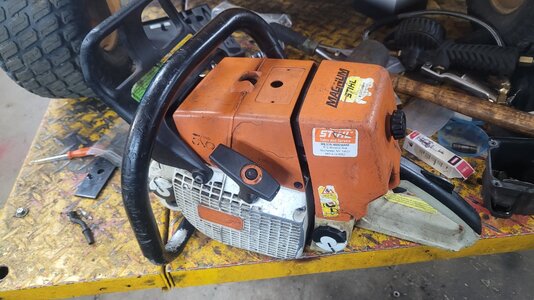

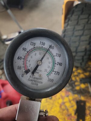

Thanks to @StihlEchoingHusky this saw lives again... joint effort on the massaging of the cylinder thanks to modern tech being able to send pics and vids back and forth... 🤣🤣🤣 ms460 with hyway big bore 54mm with a pop up piston... compression reading is before first run, on a lightly oiled cylinder and piston...
