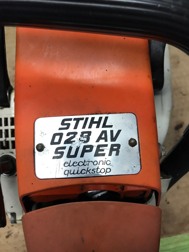

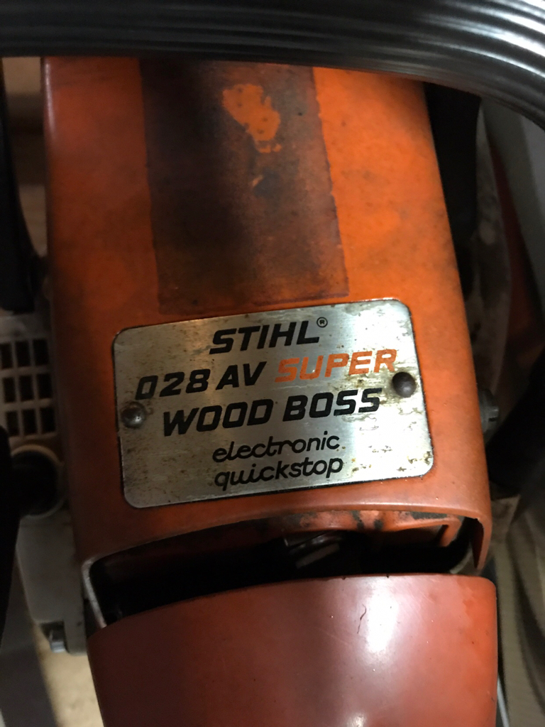

What's the difference between these two 028's (if any)?
