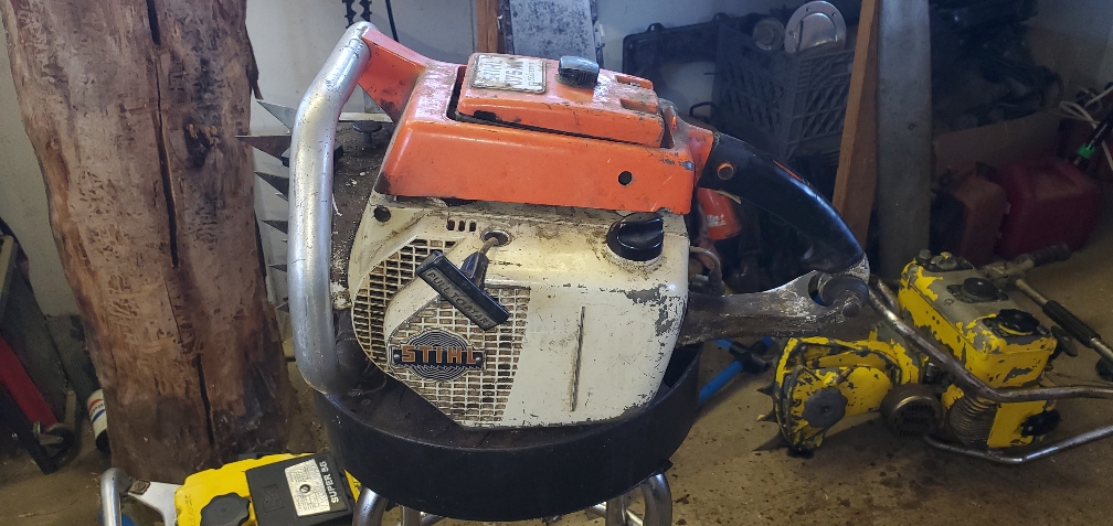

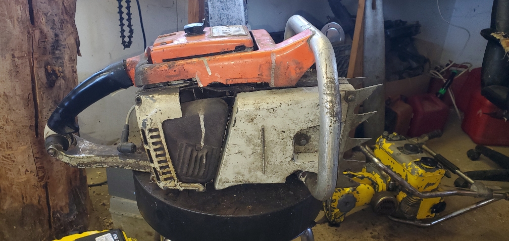

Got this 075 that I'm currently building. Posted a little on the other site but I'm using a later model 075 crankcase that has the brake ears for the brake handle. Other than being dirty it ended up being in pretty good shape. I'll re-use most of the parts on other than the crankcase and handlebar, that and I ended up pulling the trigger on a new walbro wj-112 carb. Got to use my new flywheel side puller tool on it. There's nothing wrong with my press but I really like Stihls new tool. Super easy with many different models. Just wish they would have sent all of the correct installing sleeves with it.
Sent from my SM-N970U using Tapatalk
I have several of those saws and had plans to build one this past winter but it stayed so mild we ended up much busier doing trees than normal, not to mention I built around 12 other saws that needed done.....

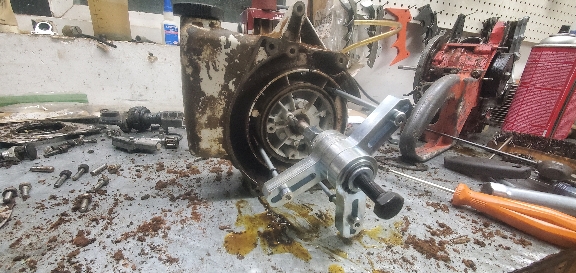

Hey guys.
I'm trying to fight off a case of CAD right now, so thought I would ask about fixing what I have.
My first saw that I bought was an 026 from maybe 15 years ago on the other site. It came with a piston that had some carbon scoring, but still ran well. The seller was a super stand-up guy and gave me the $ for an OEM piston that I still have sitting in a box ...
So it's starting to get really tired, and probably time to swap it over and get some pep back in it's step. I probably should do the seals at the same time since they havent been done, but I know they are a PITA on that saw. I have the Lisle seal puller, but from what I have read the Stihl tool comes in real handy here.
Any tips on making sure a refresh on my saw goes well? Any secrets for the seals?

My first rebuild was an 026 with a roached top end given to me by a neighbor many years ago. A little reading online led me straight to the notorious f/w side seal as the likely culprit..., and my first homebrew seal puller experience. Piece o' cake.
Clarkbug
11:33 PM
25017
Sep 19, 2022
98
107
Northeast
First thing I saw was the chain and I was really confused for a second.
I guess I need to clean off my work bench, find my various bits and pieces of chainsaw stuff, and get to tinkering...
Are those seals still available from the dealer? Any tips to reinstall without ruining them?
PogoInTheWoods
11:33 PM
1190
Apr 23, 2016
1,957
3,908
Ohio
The chain and the maul were what got it out! LOL
The seals are still available, but my first tip would be to leave them alone if there's no evidence of an air leak. May also want to invest in a MityVac 8500 if you intend to get into a few more saws along the way. A vac/pressure test is the most valuable diagnostic test you can do.
If you do decide to change the seals, you may save yourself a ton of aggrevation by just notching a Stihl tuner screwdriver to pry the seal out. My Lisle puller just hangs on a hook in favor of several other more effective methods of popping seals -- at least for me.
When removing the smaller seal, take note of its recessed position in the case and try to approximate that when installing a new one. Not super critical, but you don't want it right up against the bearing. Most guys just use a socket to tap it in.
Use a dab of grease on the inner seal lip and go easy so as not to invert the lip and pop the garter spring inside. Usually not an issue on a tapered flywheel side shaft and more need for concern on the PTO side.
Lots of tips and tricks out there for doing seals.
There's a gasket set that includes both seals, case gasket, base gasket, and muffler gasket for around $15.00. Usually saves a couple bucks on the seals alone. Part #1121-007-1050
Good luck.
