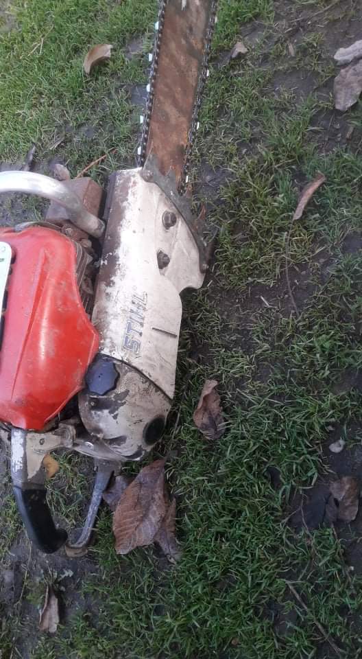

Also, why is does this clutch cover have embossed stihl logo, but almost every 070/090/Contra on google doesnt ?
bulletpruf
8:39 AM
3634
Jul 22, 2017
867
3,023
San Antonio, TX
Sure looks like a Contra to me. @bulletpruf can call it for you.
Later Lightning/Contra. Starter looks original; just not the earlier style. Clutch/sprocket cover from a later saw. Looks like it has what's referred to as the less common (but quieter) jungle muffler, but hard to tell from the pics. Likely 106cc; the 137cc Lightning S/Contra S are quite rare.

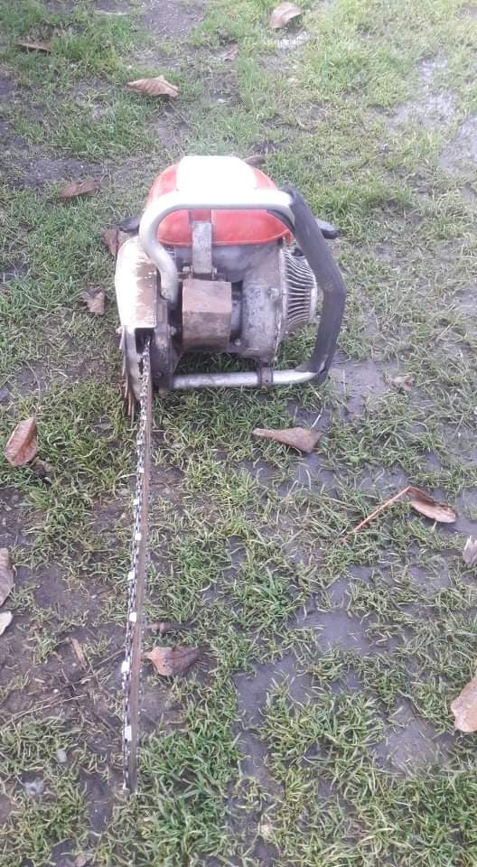

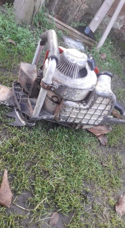

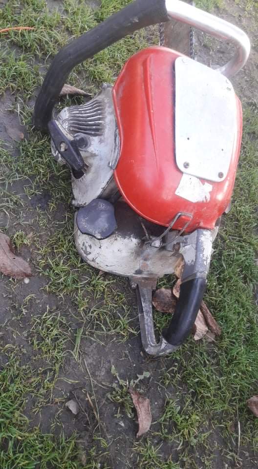

More pics that guy sent me.
Too bad the recoil is busted, but i guess its worth it, right?
Looks like DIY muffler to me lol.
Poslano sa mog STK-LX1 koristeći Tapatalk
bulletpruf
8:39 AM
3634
Jul 22, 2017
867
3,023
San Antonio, TX
Got a deal for 60$.
Its a running saw, guy sent me a video,just needs carburetor rebuilt, but ill do a complete overhaul of course.
That is indeed a nice saw bulletpruf.
$60? That's a great deal!!! Yes, the muffler is homemade. Just remember that if you look for a original replacement that the Contra muffler is different than the 070/090. Check saegenspezi.com (I think that's it). They sell a lot of reproduction parts.
