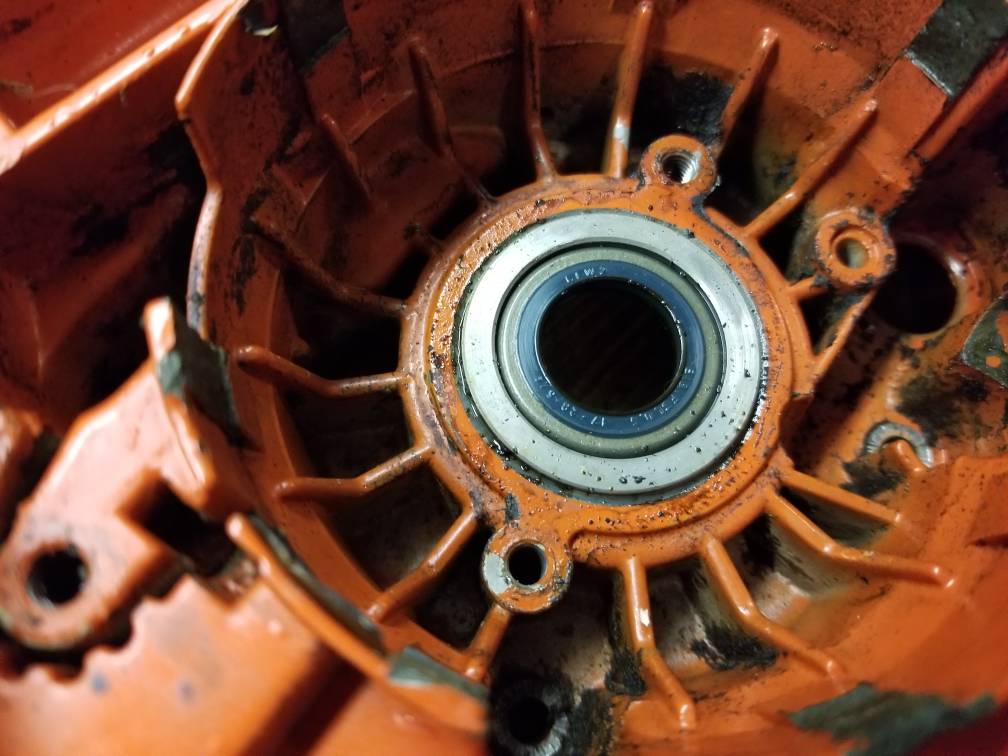

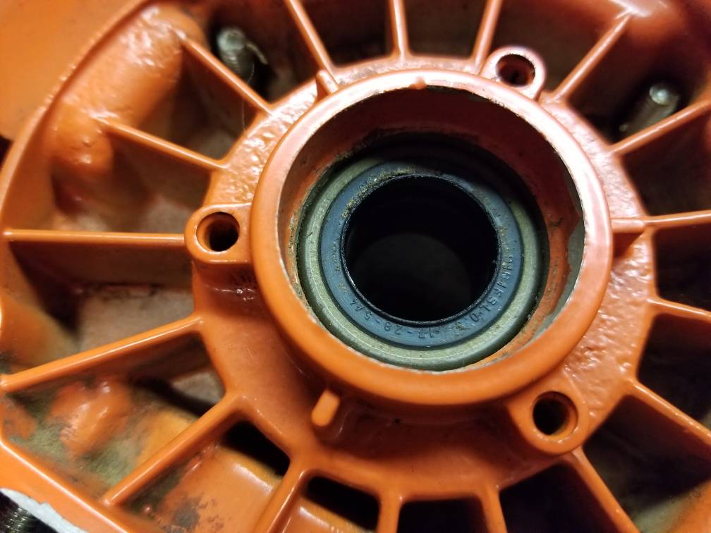

The worm Gear is still on the crank for the oil pump. I am not ready to do the seals anyway. Waiting on parts and the money to buy parts. Just trying to source any tools I may need before I start. I have an assortment of seal tools from Stihl and. Husky I am sure I can find some thing that will fit.
Flywheel and PTO side. Pull the oil pump. There is a pressed on gear that has to come off to get the seal. After that easy. Then you have to press on the gear to the shoulder.
