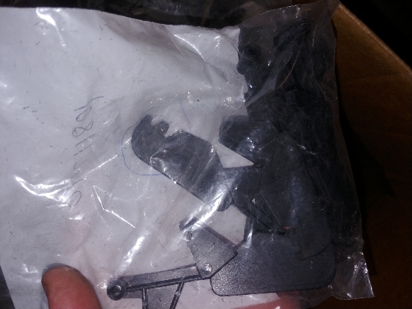

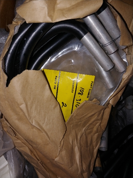

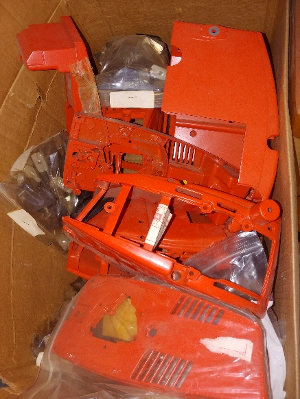

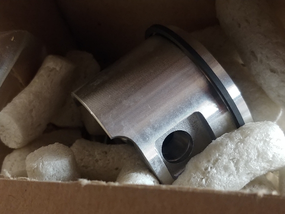

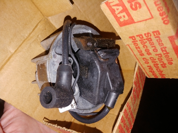

Parts order arrived from two different warehouses today. Will get the clutch and pump drive on next order sometime in the new year. Time of the year to think of others is upon us.

Out of curiosity, are the chains made in USA or Canada? I've read that Oregon is having chain made in china now. Thanks

These are US made. Older stock I assume. They no longer sell a 20" 3/8 wearing saw.
Nice parts haul, I need to do similar for my 7901, where did you order from?
Directly from Makita. A work perk. I plan to keep this stuff alive for as long as I care to use it. Everyone whinges about parts availability...but I've not been denied anything I've asked them for yet.
