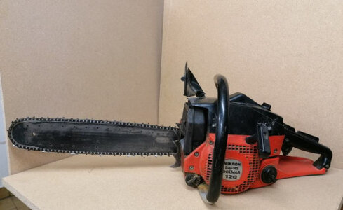

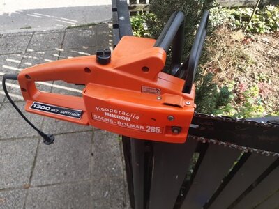

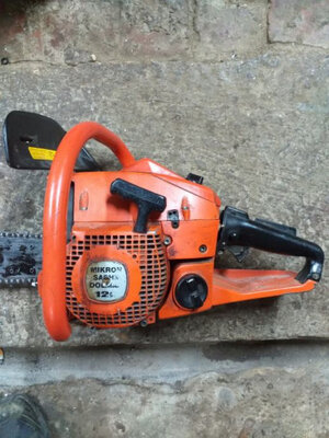

That MIKRON SACHS-DOLMAR is a rare find, congratulations!
Do you have more info about the MIKRON saws? As far as I know, they were assembled in former Yugoslavia by "Kooperacija Mikron" either in license from Sachs-Dolmar or form parts supplied by the german factory.
Do you know which models were produced?
Apparently a couple other models have been assembled by Mikron.
Pictures are courtesy of my source.

Exactly the same pics showing the same models I have seen somewhere else before.
Most likely same source, or my source got the pictures from where You have seen them.
I did not say that those were my pictures. ;)
