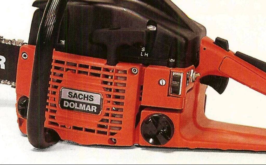

Original models had this switch setup.
They used swamp water for lube, that is nasty.Well I got my dcs-9000 from @ajschainsaws.

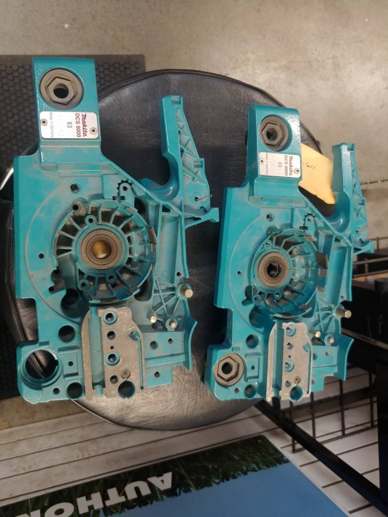

Ok so I was going through my dolmar boxes last night and in the 5100 box it looks like I’m 1-2 parts from assembling one...
Figured I’d ask to swap my 5105 cover for someone else’s 5100s cover, or figure out how to modify my 5105 cover to fit the 5100s case?
I think... he wants to see behind the cover and expose the switch .

How different are they?
Not by much but I don’t want to start hacking on the underside of the cover and wreck my pre-filtration into the carb box. Figured someone else has either modified one of these covers before and could push me in the right direction or easier solution is to use the right parts and swap with someone.
