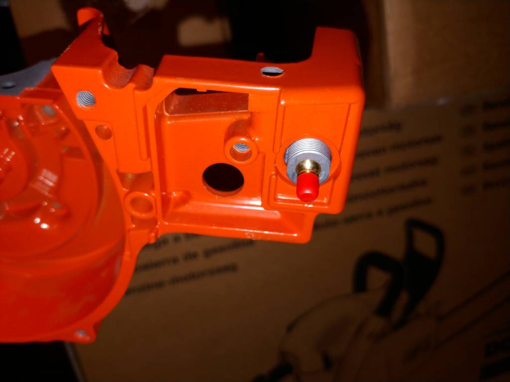

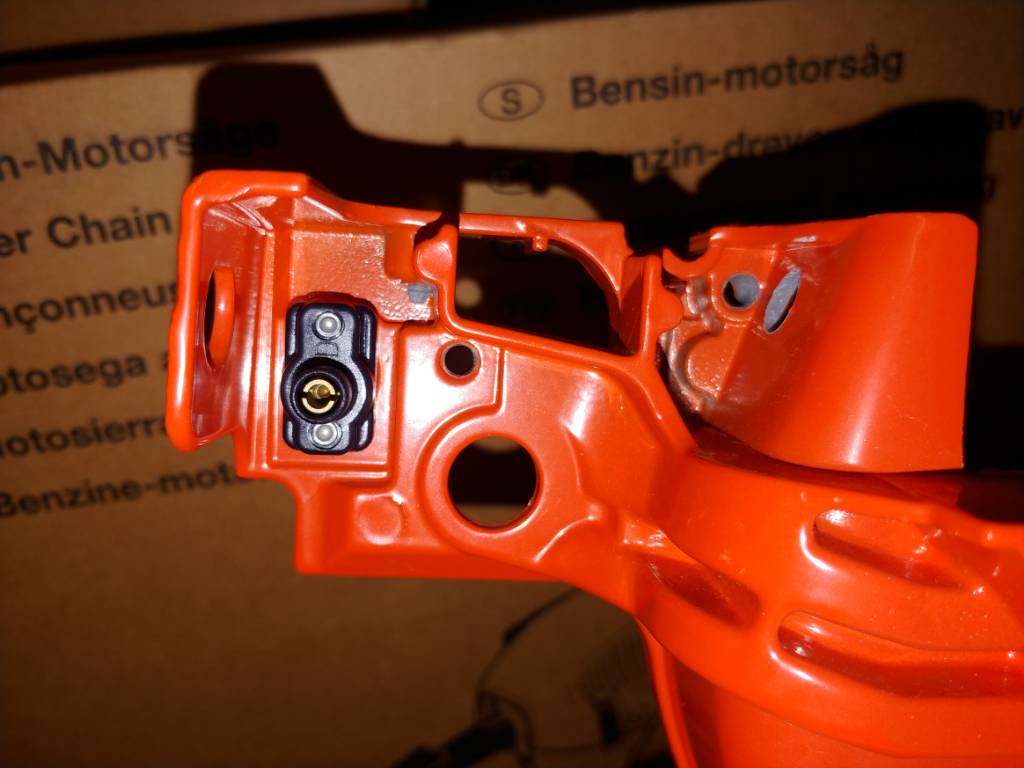

Ok so I was going through my dolmar boxes last night and in the 5100 box it looks like I’m 1-2 parts from assembling one...
Figured I’d ask to swap my 5105 cover for someone else’s 5100s cover, or figure out how to modify my 5105 cover to fit the 5100s case?
