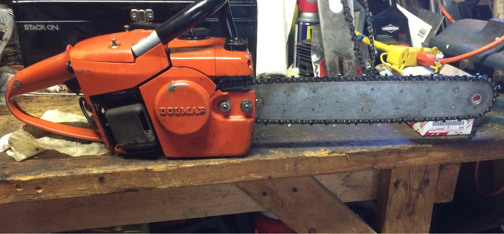

Got to run the 118 last night and was quite pleased. Seemed to starve for fuel after awhile so it’s going to get a new fuel filter this afternoon.

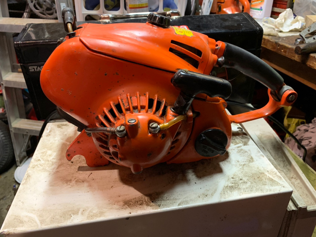

Got another Dolmar that I’ve never seen before. It reminds me of a small CT. This project came from France so shipping was pretty high. Anxious to get it going for some GTG exercise!

It’s a Model CA. I have the front handle off as it is part of the clutch cover. Made for 12 yrs, 1966 onward. 56 cc. It came with another one for parts, parts saw has the handle mount broken from the crankcase in front.

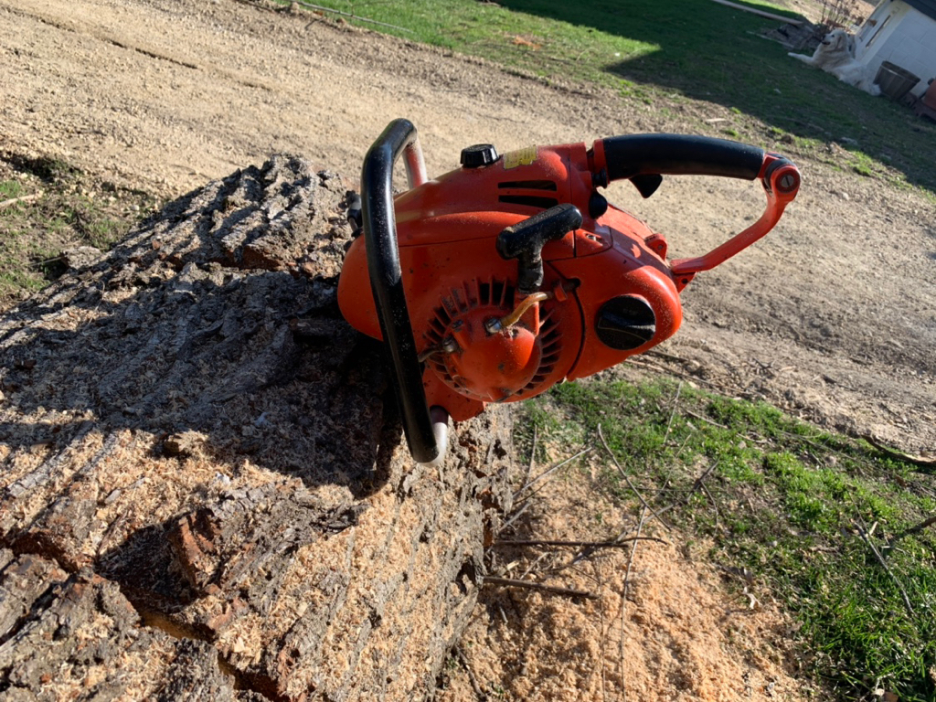

I got to cut with the CA today. I replaced the fuel lines and a carb kit after I got it to pop a few times with prime. There was a terrible residue in the carb, and the fuel line looked like a wad of black bubble gum in the tank. Chain needs work, but that’s easy. It pulls pretty well, and restarts easily. Off to the Iowa GTG we go!
